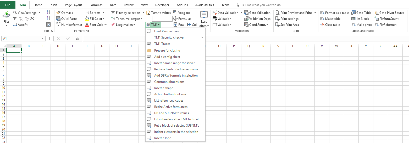

- the space (screen real estate) in the ribbon is 'limited', so therefore I create menu's in my menu. Like the TM1 menu shown in the picture. But more than that, a number of options allow the use of Shift and/or Ctrl click when clicking the option. That way, the functionality changes.
Have a look at the option of Autofit in the lower left corner. If you click on it, the columns in the selection will be autofitted.
If you Shift-click on it, you go to the dialog where you can enter the column width yourself (no autofit in that case).
If you Ctrl-click on it, you can autofit the row heights of the rows in the selection.
This way, we can avoid userforms / Inputboxes / MsgBoxes / ... since time is money
- a number of the options are a complete rewrite/makeover of an existing Excel dialog. Like QuickPaste is in fact Copy > Paste Special but the choices are not mutually exclusive
I can for instance copy/paste the formulas, column widths and bold/italic/underlined in 1 screen.
- "Files" has options to close and save the active file (at once), or save to the desktop, get the full path and file name (for copy/paste elsewhere), "close and delete the active file", close all but the active file, and so on.
