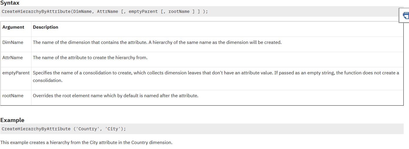

I was trying to create a hierarchy based on the attributes using the CreateHierarchyByAttribute function in Ti process.
Somehow when i run the process it says "CreateHierarchyByAttribute" function failed.
I have used the syntax as given in documentation,
P.S the parameter in cfg file to enable hierarchy creation is set to T.
Please let me know if I'm doing anything wrong. Could you also let me know how this new attribute hierarchy can be accessed in Tm1 web.

I'm not convinced you will be able to see the hierarchy in TM1 Web, pretty sure it is only available in PAW and PAX. The "old" clients won't be able to see them, I'm slightly hesitant as I know they refreshed TM1 Web a little in the last release and I have not directly checked.
As for your error, suggest you put your actual code and the error message, I've not encountered issues using that function.
It might be for some secondary reason like you have an invalid rule sheet or the creation of the hierarchy is invalidating a rule sheet, something like that.
