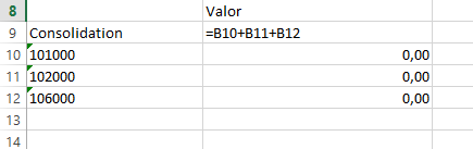

The rows are static at slice option, so You include or exclude every row that You want. Them You have to make a formula to that Consolidation that Doesn't exist as a dimension element to have a value in that data point!
I made an example attached below.
PS.: This only works in rows, I don't know If there is a rollup available to Subnm for example!

- Rollup.png (3.39 KiB) Viewed 26829 times
