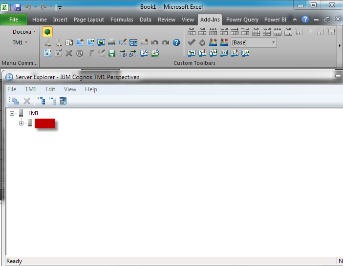

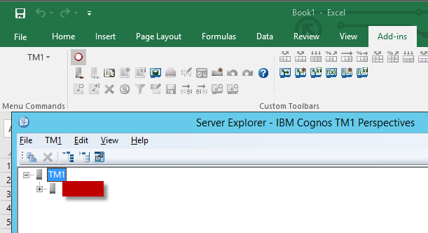

We are in the mid of upgrading from TM1 10.1.1 to TM1 10.2.2, with FP6. TM1 Perspectives work as expected, for almost all features, when we use Excel 2010. However; when accessing the same server from Excel 2016, even after logging on to the server, there's no change in Perspectives' buttons' state. All buttons are disabled, and the status of server circle does not change from red to green.

Any ideas what's going on and how to resolve this?

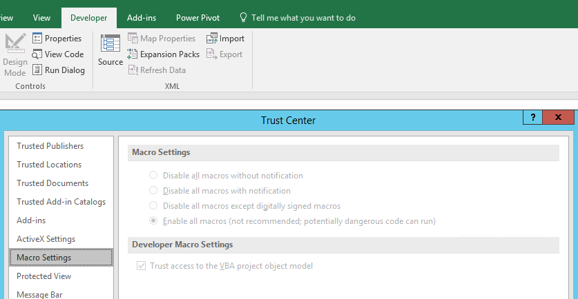

What's the macro security level set to? I'm not certain it could have something to do with it but it's something worth looking at,

Hi Jim,
It is set to Enable all macros.
