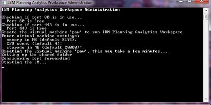

The crash is happening when it is starting the PAW administrator. I have tried reinstalling PAW, docker tool but it did not help.
Please let us know if i am missing something in the installation. Also please share your ideas on the fix if you have encountered something like the above.

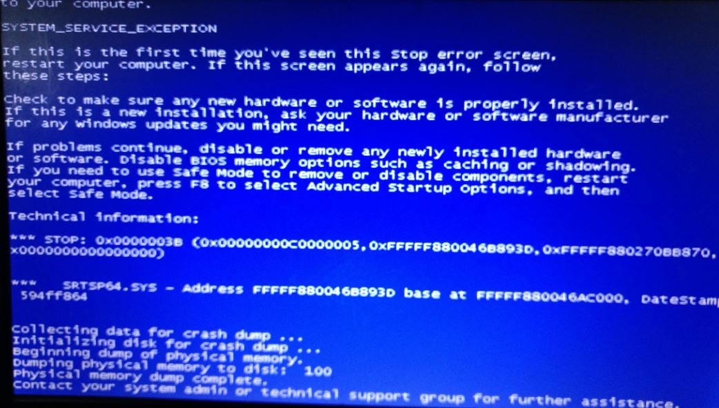

SRTSP64.sys is a Symantec driver. Ensure you have the latest version of your virus scanner (and sufficient RAM).

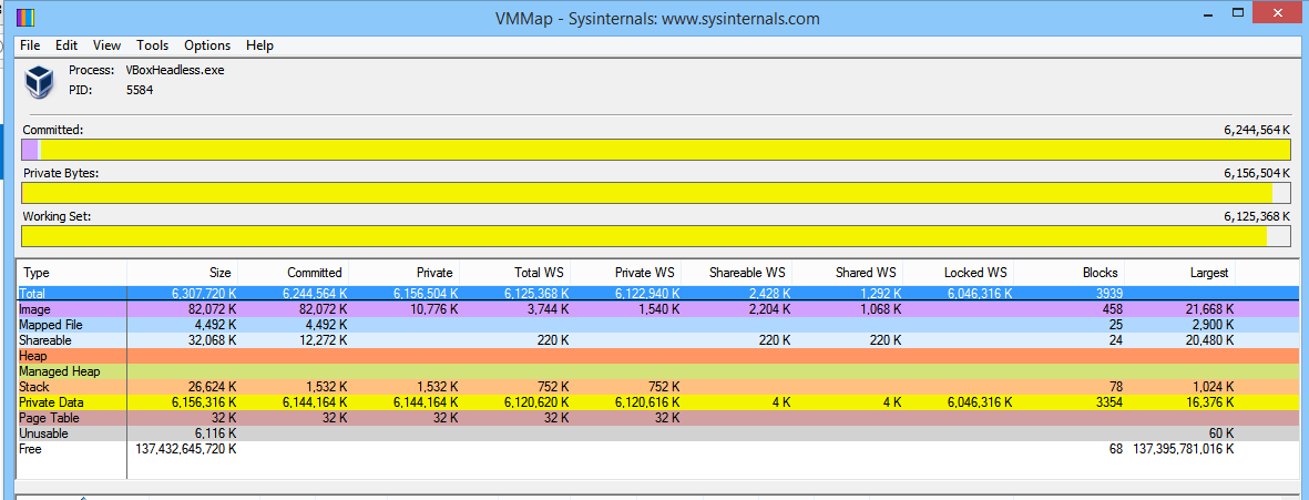

Found a SysInternals app called VMMap - Allows you to find out a lot more detail on the memory usage of each of the VMs running:
The above on my machine is pretty much a vanilla install with one Book with one Sheet and one small view-not sure as to how this will grow as more workspace objects are added.
At the very least, you can see what memory the VM is consuming, take a baseline and monitor.

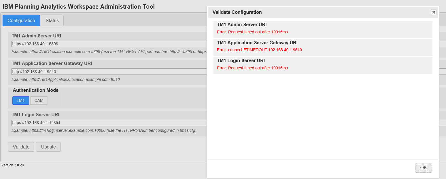

Thanks for your suggestion, i was able to install PAW successfully after adding additional RAM on my laptop. I could not pass the validation for configuration on PA Admin screen, i am providing the following URI values but i am getting timeout error for all below 3 URIs.
Starting PA admin tool has launched this url on IE - http://192.168.40.100:8888/ for configuration.
Entered the below values
TM1 Admin Server URI - https://192.168.40.1:5898 ( also tried with http://192.168.40.1:5895)
TM1 Application Server Gateway URI - http://192.168.40.1:9510
TM1 Login Server URI - https://192.168.40.1:12354 ( Port 12354 is the HttpPortNumber for my planning sample instance running on my laptop)
Authentication Mode - TM1
Attached the screenshot of the config screen. Please let me know what i am missing on the configuration portion.

If you try those URLs in your Windows browser do they work?
Try:
https://192.168.40.1:5988/api/v1/Servers
If you have a firewall or virus scanner, temporarily disable it.
Try:

As the good doctor alludes to with his mentioning of the firewall; that is the response I get if I forget to allow the required ports through.

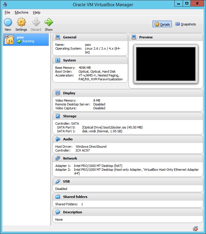

Sorry this is very long. I am hoping that there is someone out there who is curious enough to try to diagnose the problem.
I upped the memory to be allocated to the virtual machine to 4096MB ie 4GB.
I then got
I ran Start.Bat and replied n so I got to the $ prompt. I then tried docker-machine regenerate-certs paw.
I then ran Start.bat again, said n to images and y to administration tool. It tried to start this on 192.168.40.100:8888 but got
192.168.40.100 refused to connect.
I added 8888 to the FIrewall but it still did not work.
One thing that seems odd is that in Network Connections I have 4 VirtualBox Host-Only Networks. It seems to regularly create another one. I have disabled all by the latest #4 one.
Tried Start.bat again saying y to Docker images although they should already be there. This gave
There was an up.log from when it tried to start the administration tool earlier. This had
However, it seems that the Admin tool cannot be accessed in the browser.
Does anyone have any clues as to what is wrong?
Paul Simon

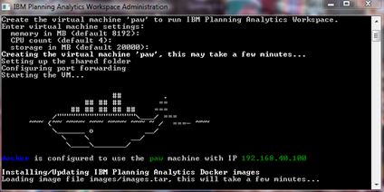

The log file referenced did not exist.docker is configured to use the paw machine with IP 192.168.40.100
Install/Update IBM Planning Analytics Docker images (y/n)? (default n): y
Installing/Updating IBM Planning Analytics Docker images
Loading image file images/images.tar, this will take a few minutes...
Looks like something went wrong in step "Installing/Updating IBM Planning Analyt
ics Docker images"...
Check the log file /c/TM1/Releases/PA_2-0-3/paw/log/admintool/start_2018_05_03_2
3_46_10.log...
Press Enter to exit...
