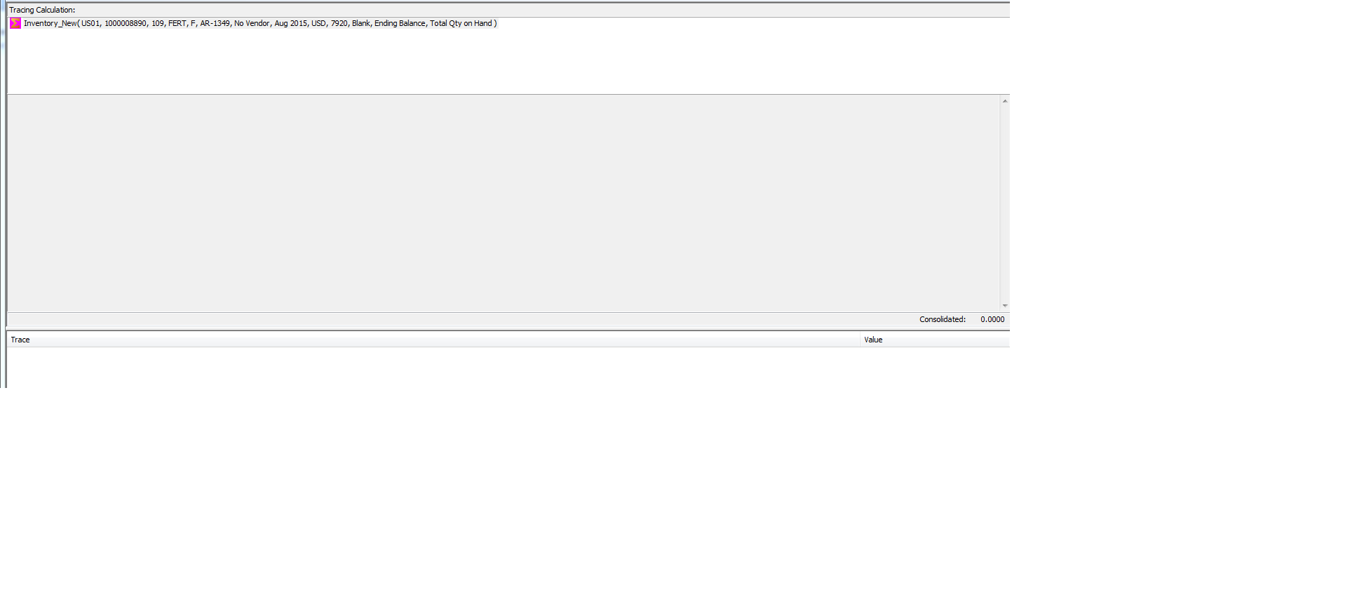

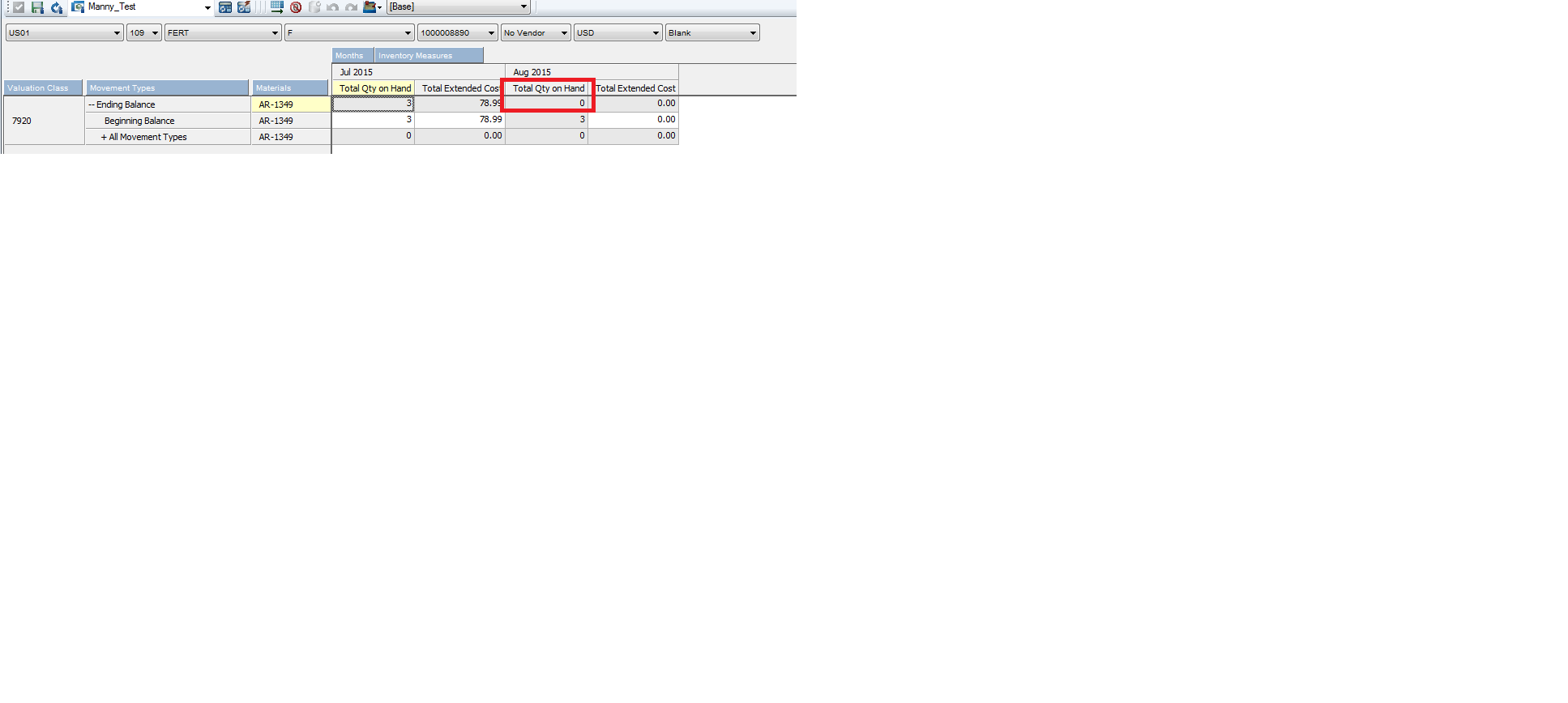

My issue is the consolidation doesnt take place for August , total quantity on hand .
Attached the screen shot of the issuse .

Your rule is pulling from prior month so you need to alter your feeder to push to the next month. Currently you are feeding the same month.

Re: Rule consolidation Issue
Just like you have an attribute on your Months dimension called "Prior", so should you have one called "Next". Then your feeder would look something like this:
You have to use the full DB syntax in order to do this. Substitute your cube name and dimension names in above. The ATTRS code string would replace the !Months reference in the rule.
['Ending Balance'] => DB(CubeName, Dim1, Dim2,..., ATTRS('Months', !Months, 'Next'), 'Beginning Balance');-
Okay this worked perfectly .
