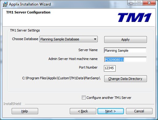

Unfortunately the installation of databases/services during program installation is done via one of the most annoying dialogs ever created.
Figure 1 - TM1 Server Configuration
Choose Database allows you to select from:
(a) The Planning Sample database;
(b) The Sample database or
(c) A Custom database.
The first two are predefined example sets of cubes, dimensions and other TM1 objects which are referred to in some training materials. If you're a new TM1 user it's recommended that you install at least one of these, if only to have a tm1s.cfg server configuration file created which you can then copy and modify for your own databases.
"Custom database" refers to a folder in which you can create your own cubes. I tend not to install custom databases via this dialog and prefer to do it via the command line after installation. That's partly because I find this dialog seriously annoying and finicky to work with, but mostly because I prefer to give each server a unique process name (as will be discussed later), thus allowing me to identify the processor and memory usage of each one in Windows Task Manager.
Server Name is obviously the server name that will be seen in Server Explorer when the TM1 Server is running. Each database that you specify will have a separate service created in the services list of the Computer Management Console; the service will appear under the name TM1 Server - ServerName. This is equivalent to the -n parameter when installing the service from a command line, and in the application shortcut that was discussed earlier.
In most cases the Admin Server host machine name will be the name of the Windows sever that you're installing TM1 onto. (It's the name of the machine on which the Admin Server that you want the TM1 Server to register itself with will be running, but as often as not that's the same machine.) This entry doesn't affect the creation of the TM1 Server service. (If you create the service outside of the installation package, that is, via the command line, then this isn't a value that you need to (or can) can specify.) I believe that this value is only used in creating the tm1s.cfg file that will be placed in the database directory by the installation package.
The Port Number is the Windows port number that the TM1 Server will use in communications. Each TM1 Server needs to use a unique port number. If you're creating multiple servers, plan in advance which port numbers you're going to use because if you have two TM1 servers running which are using the same port numbers, you'll have problems connecting to them. The default one recommended by the installation package is 12345. If you define more than one server here, the next one will have a default port of 12346, and so on. The range of valid port numbers is 5001 to 49151. (5000 is used by Local servers which run on your own computer rather than on a Windows server.) As with the Admin server, this information doesn't need to be supplied when you're creating a service outside of the installation package. (Nor is it stored with the service definition in the Registry.) Accordingly I again believe that this information will only be used to create your tm1s.cfg file, not the service.
You can change the directory in which the cubes, dimensions etcetera will be stored in via the [Change Data Directory] button. By default this goes into a "Custom" folder under the TM1 Application folder. CAUTION! You must change this folder location if you're working on Vista (and presumably Server 2008 at some point in the future when it becomes supported), since Vista will not allow you to store data files in a folder in the Program Files path. Instead it redirects some data files off to some obscure location (without telling you) which will cause you a great deal of frustration and confusion. The folder that you specify here will be the one that the service will look to to find the tm1s.cfg configuration file. It's equivalent to the -z parameter when you're installing the service from a command line, or when creating a shortcut to the application executable.
Tip: Do NOT click on the [Apply] button after you change the data directory, or it will bounce back to the default folder. (Hence, "one of the most annoying dialogs ever created".)
If you are creating only one TM1 server service, you can click on the [Next] button to move on to the next installation dialog. Alternatively, if you wish to create a second or third TM1 server service you need to click on the Configure another TM1 Server box before you do that.
Tip: If you're already on the second service and you don't want to configure any more services, the [Next] button will be ghosted until you click the [Apply] button. At which time, as noted above, the data directory will reset to the default one. (Hence again, "one of the most annoying dialogs ever created".) Change your data directory again if you need to, or avoid the problem by entering every setting except the data directory one, clicking on [Apply], then changing the directory followed by clicking the [Next] button.
If you do a Standard install rather than a Custom one, only the Planning Sample database is installed. You then need to create your own database and service manually, as discussed later.

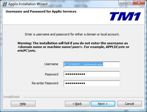

Windows Accounts And Services
When you log on to Windows and run a program (say, Excel or Word) on your own computer, it's running under the account that you log in with. The program therefore relies on the permissions that your login has to access the system and any external resources like printers or shared drives.
Similarly a TM1 Server Service (as well as the TM1 Admin Server service) need to run under an account even though this is something that a new user might not think about.
When you're doing the installation you will be asked to specify a user name and password for TM1 services as shown in the dialog below.
Figure 2 - User Name / Password
Caution: Do not be tempted to skip these entries. If you do so in 9.0 at least, the installation won't fail despite the warning shown at the top of the dialog. However the Admin Server will be installed to run under no account at all and will not start. Also, if you uninstall TM1 without rectifying that, the uninstall script won't be able to remove the Admin Server service though it will flag it for deletion. It takes a reboot of Windows to get rid of it. (Any subsequent attempt to install TM1 prior to that reboot will fail given that the Admin Server service is still there.) It's possible to change the account that a Service runs under as discussed later, but it's best to get it right in the first place and avoid the aggravation.
The Admin Server Service, and any TM1 servers that you created during installation will all run under the account that you specify in the Figure 2 dialog. It's therefore important to specify an account which will have access to all system resources that TM1 requires.

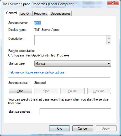

You can change several of a Service's properties by right clicking on the service in the Services list of the Computer Management Console, and selecting Properties. The dialog that you'll see will be similar to the one below.
Figure 3 - Configuring a Service via the Computer Management Console
Things to note:
(a) You can see the TM1 Server name that was specified in the -n parameter in both the "Service name", and the "Display name"
(b) Note that the "Path to executable" shows the path to the copy of the tm1sd.exe file that I created rather than the original one.
(c) New services that you create from the command line will typically have a startup type of Manual, and a service status of Stopped.
The first thing that you'll want to change is the Startup Type. You'll probably want to set this as Automatic so that the server will load automatically when the Windows server box reboots. (Except for the sample database(s) that were installed by the installation program, anyway. The services created by the installation program are already set to Automatic, and you'll most likely want to change them to Manual since you'll only want them running if you're working through the examples in the manuals.)
