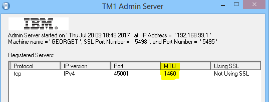

Does anyone know how to adjust the MTU on the admin server and if this will impact on how Perspectives "talks" to the server?
My thought process here is that where I have perspectives clients connecting over a WAN/3G connection, performance must improve if we align MTU i.e. data bucket sizes.
I cannot see anything relating to this in Cognos Configuration (10.2.2 and PA 2.0.1) or in the Ops guide for previous versions (unless you go back to some really old posts on this forum i.e. v8 days)
p.s. I do not/would not normally run the Admin Server in application mode-was fiddling around on my dev system and noticed the MTU column
BR, George.

To the best of my knowledge it's not actually configurable.
However, the admin server is really only used for discovery. Login and all other operations are done directly with the TM1 Server and do not pass through the admin server in any way.

Thanks Brian, was rather hoping that tweaking would set all comms. The poor performances over MPLS networks vs better over some 3G/LTE seems to be down to smaller packet sizes accommodating the chatty traffic better.
