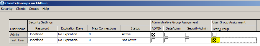

1.Add A User
Right Click Server >> Security >> Clients/ Groups
Add a new client or a new group if required,
(an example could be add the user 'Test_User' into a new group called 'Test_Group'.)
