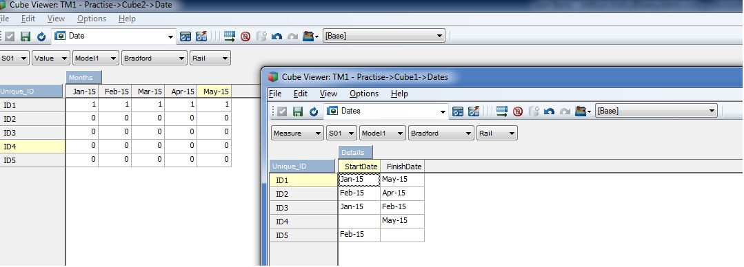

Mithun.Mistry1103
- Posts: 63
- Joined: Thu Jul 03, 2014 1:14 pm
- OLAP Product: cognos
Re: CELLPUTN
Hello Wim
The format is the same - both strings and Month Period nodes.
Cube 1 -
dim1 - UniqueID
dim2 - Place
dim3 - Type
dim4 - unit
dim5 - model
dim6- Measure
Dim7 - Details ( 2 elements, startdate (Intersection: Jan-15), finishdate (intersection: Dec-34))
Cube 2 -
dim1 - UniqueID
dim2 - Place
dim3 - Type
dim4 - unit
dim5 - model
dim6- Measure
Dim7 - Months (Jan-15, ..,, ... , Dec -34)
Just using data views from cubes.
I am attaching a similar format to what I am currently looking at with all referred dimensions.
Thank you for the help

Re: CELLPUTN
It complicates matters if StartDate and/or FinishDate is empty, but if they were both non-empty or both empty, then this will work:
Create a view on Cube1 in the Prolog section of the Advanced tab. Select in the dimension Details on element StartDate.
That way, you can loop over all non-zero StartDate cells
Also, do a zero out on Cube2 for the relevant cells
In the Data tab of the Advanced tab, write:
This further assumes:
- input in Cube2 has the same month names as in dimension Months can be found
- the months in dimension Months are sorted, index-wise, from the oldest (index 1) to the newest month (highest index). If this is the case, and you can live with the fact that indexes in that dimension should ALWAYS be correct, this will work without further changes.
Honestly, I do not know why you would write:
Instead of
Why is that ?
i = Dimix( 'Months', SValue);
While( i <= Dimix( 'Months', CellGetS( 'Cube1', UniqueID, Place, Type, unit, model, measure, 'FinishDate') ));
CellPutN( 1, 'Cube2', UniqueID, Place, Type, unit, model, measure, Dimnm( 'Months', i ));
i = i + 1;
End;This further assumes:
cellputN(STRINGTONUMBER('1'),Code: Select all
cellputN(1, Best regards,

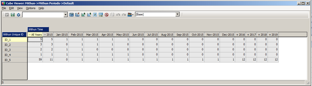

Hi Mithun, Im guessing you want to turn this
Into this?
Have you considered doing it in TM1 rules?
I think the main thing you need is give your time dimension a number attribute that it can use for period checking rather strings see below for an example
Into this?

Re: CELLPUTN
Have you considered doing it in rules, that way you dont have to run a TI after every change.
Here are the cubes i've created based upon yours.
And here are the rules for each of the cubes.
It may look a bit complicated, but its really good and makes TM1 faster as it doesn't feed cells it doesn't need to and as it looks like your using a lot of from and too dates that may be a good thing. it depends on how you feel about conditional feeding.
What happens is that when you change one of the dates in your Start End cube the string change always fires the feeders (unlike numeric cells).
The feeder section on a change of start date or end date fires forward from the start date and backwards from the end date but only where it falls in the range, so its all automatically fed.
What complicates it more is that you are using blank, so i've used as a default
start date blank = from the first period,
end date blank = to the last period.
- JulianS
- Posts: 20
- Joined: Fri Jul 07, 2017 1:34 pm
- Version: 10.3
- Excel Version: 2013
Re: CELLPUTN
So the proof of the pudding is
Where you can see the zero is unfed, which means that its not going to feed any other cubes and waste CPU.
When we suppress zeros we get.
Which is still correct.
If you still want to do it in TI give me a shout, it will be quite easy to go through it in TI.

Re: CELLPUTN
Hi Mithun,
Here is a example that doesn't need any extra measures as its all calculated in the TI.
Its a bit more complicated than the previous one, but Wim was having issues with understanding the logic of using a view of the target cube to iterate through all the cells
and process them in turn.
So here is a quick TI I knocked together to help you doing it from the Wims suggestion (but hopefully a bit more constructively for you).
Cube Mithun_Start_End -> Mithun Periods
No new measures are required.
And to quote our friend ' Its not difficult to do'
Good luck my friend, and happy TM1ing in the future!

- Posts: 1833
Re: CELLPUTN
Happy to hear that your problem has been solved.Mithun.Mistry1103 wrote:Jules, thank you so much for coming onto the forum on my request, I appeciate all the help you've given me. I have done both solutions and they both work. Again, thank you so much.
Just to offer an alternative to the rule approach to any future users that stumble across this thread which may hopefully be easier to follow as it just focuses on populating the first period and then rolling on until the end period is found.
I caveat this by saying you should probably throw a rule at the start to force all cells to zero if the End Date is not populated.
Also with rules like this you need to be careful that you don't go past the stack overflow point; it is unlikely you will when working with a month based dimension (assuming that all actuals are done by STET'd TI values and it only calculates forecast) but if it went down to week or day level, or if you are dealing with showing the "active life" of long-term construction projects etc (we had some that exceeded 20 years at a previous company I worked with) then you could blow it.
Rule in Cube 2
[]=N:
# First populate a 1 if the Month is equal to that held in "Start Date" in Cube 1
If ( DB('mithun_1',!mithun_id,'Start Date') @= !mithun_time,
1,
# If the previous month from this one is equal to that held in "End Date" in Cube 1 then set to zero
If ( AttrS ( 'mithun_time', !mithun_time, 'Prior_Period' ) @= DB('mithun_1',!mithun_id,'End Date'),
0,
# Otherwise pull value from the previous month (1 or 0)
DB('mithun_2',!mithun_id, AttrS ( 'mithun_time', !mithun_time, 'Prior_Period' ) )
[{'Start Date','End Date'}] => DB('mithun_2',!mithun_id, DB('mithun_1',!mithun_id,'Start Date'));
