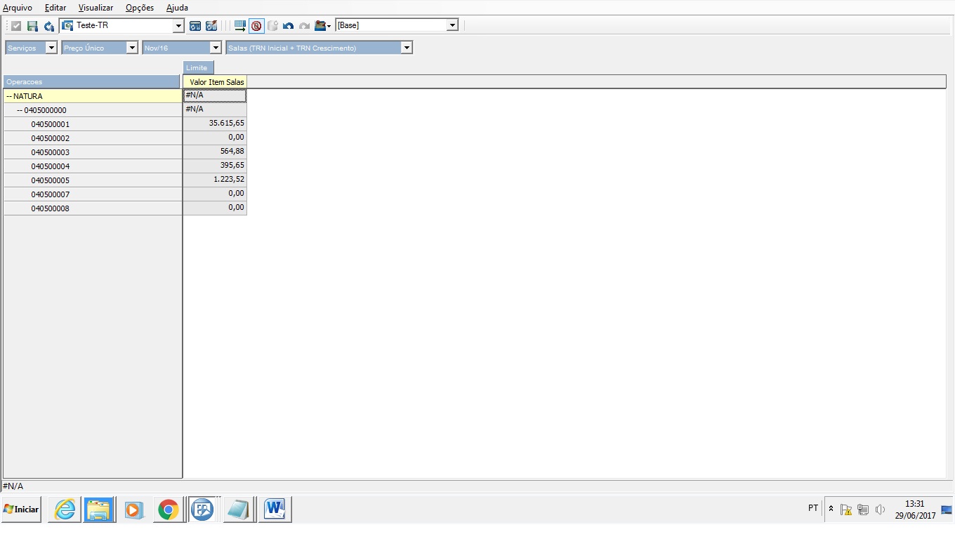

Hi everyone,
I am facing an error on summation as screenshot attached.
Does anyone knows what can be happening?
Thanks a lot,
JR

Re: Error
Do you have a calculation rule at C level ?

Re: Error
No, only at N Level.
I do not understand because all n levels are calculated and they have value.

Re: Error
The problem is on the rule.
First I have a specific calculation for a field and then the general rule. For some reason when I try to do the specific rule first I get the #N/A. I have changed this metric for another one and it worked, I just don't understand why the specific generate this problem.
Does anyone have an idea?

Re: Error
Switch your forward/ backward slashes
