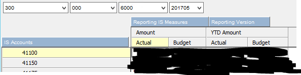

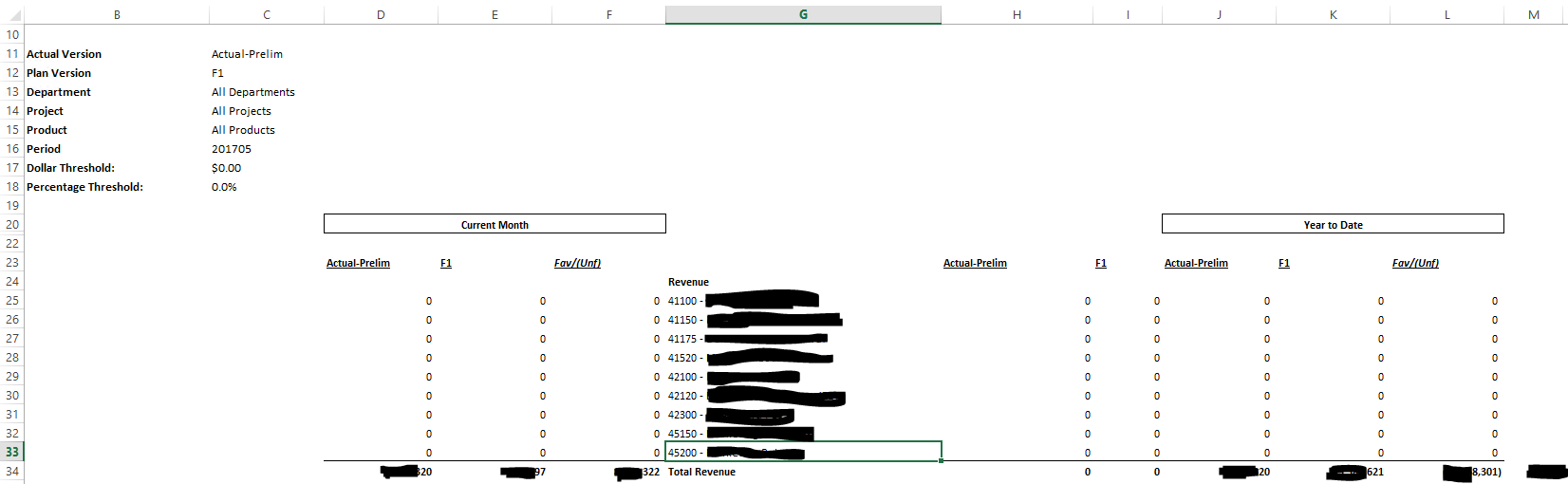

I am currently working on the attached websheet in Perspectives. The cube view it is referencing is also attached.
In the websheet, rows 13-16 are all context filters in the view, and can be changed in the sheet and still provide data after being recalculated. Rows 11 and 12 are not filters in the view, and are set up as SUBNM functions in the sheet, with row 23 referencing the values in the SUBNM cells. Whenever I select something other than the two versions in the view (Actual and Budget), the numbers show immediately after selecting it, but disappear after recalculating the sheet. Since this is intended to be a websheet, this will just always provide me with zeros when selecting a new version.
Is this due to the other versions not being in the cube view? If so, has anyone else faced this, and how have you addressed it? Is there something else here I am missing? Also, for reference, columns G-L correspond to the view, while D-F are DBRW functions.
Thanks in advance.

Have you added any additional calculations? For example you may have added Excel calcs that derive an element used in the DB statements. If you have it may be down to calculation order. Try changing a DBRW in to a DBR. If it's not this you'll to provide more information regarding the sheet. It doesn't look like a straight slice.
Re: Perspectives - Values Disappearing After Recalc
Seeing that the SUBNM starts on row 11 I am guessing that this is not a slice but an Active Form.
In which case ...
In which case ...
Yes it is. For cells belonging to another slice you can't use the TM1RptView reference as the cube reference in the DBRW. You need to use another VIEW reference (or hardcoded server:cube string but this could have performance drawback vs. proper View formula). But for the active form to still work you must have at least one column referring to the TM1RptView.DavidS wrote:Is this due to the other versions not being in the cube view?
Is this an active form or just a slice? You have a version in C11 and a version in C12 so if it's an active form which version is referenced in the TM1RPTVIEW formula? Is there just one TMRPTVIEW formula and you are pointing both the Actual and the Budget DBRWs to that same VIEW? That's not going to work. You need to put the version dimension on the columns instead of a title dimension if that's the case.
