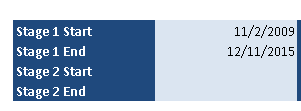

I'm currently working with 10.1.1. I've created a web sheet where users will update project stage dates. Within Excel when a date is missing it shows as blank but when published in TM1 Web it displays a date that corresponds to the date value of 0. To give you more background we store the date values as numeric values and then format the cube display. In Excel I have set the format to dd/mm/yyyy. I've done some digging and it sounds like I can't do anything about it. Could somebody confirm if this is the case?
Excel view:
Excel Dates.PNG (2.15 KiB) Viewed 6305 times
Web view:
TM1 Web Dates.PNG (2.44 KiB) Viewed 6305 times

You just need to use the excel formatting to indicate what to do for zero value so "dd-mm-yy;;" will display as blank for minus and zero.
Problem is when you enter a date from blank; the web format can be annoying and require it in a very specific format dependent on region (more specific than changing from one date to another) but user training should get you there.

Thanks for getting back to me so quickly Declan. I tried to move to custom and went for dd/mm/yyyy;; and this what I got:
TM1 Web Dates2.PNG (2.64 KiB) Viewed 6290 times
Do you think something like mm/dd/yyyy;-; will work?

Nailed it using the following format: mm/dd/yyyy;;""
