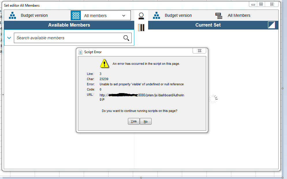

Error accessing set editor from PAx
Post by Paul Segal »
Anyone else come across this? Everything else seems to be working OK. This is accessing GO_New_Stores, so should be fairly standard.
Paul
Re: Error accessing set editor from PAx
The pre-requisite that is often missed is that IE11 is required on pax machines, this looks like that error.
It doesn't look like that's it - IE11 is installed, and I've even made it default now. I still get the same result.
Did you point PAx at PAW, rather than the TM1 Service? That is the other area that generates an error when getting into the common objects. I don't think that is it since I think that is a simple 404 error.
I did (I'm pretty sure). I get the PAW-like logon screen, which works and lets me in.
Well, I've fixed it, but not cured it. I had the http port set to 8080 on the PAW start.bat rather than 80 as there was something else on 80. I've got rid of the something else and rebuilt PAW using port 80 and it now works. Thanks for the help though, Steve.
