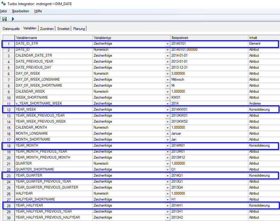

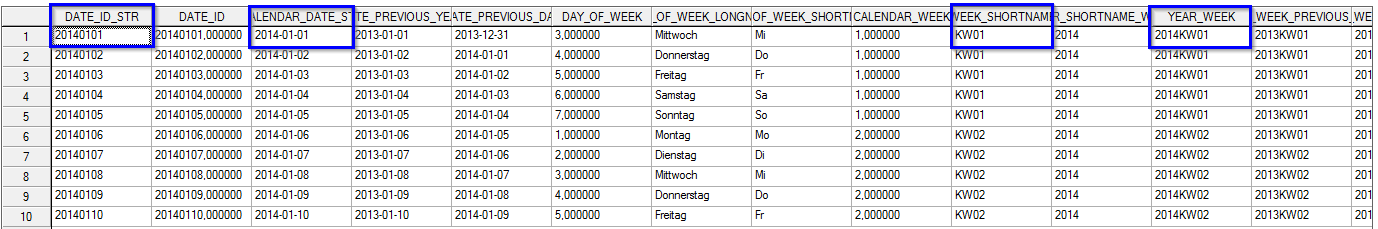

You need to prepare a data source for this having a PK for each granular item and for each level an identifier also as a label value (in my case it's an import via ODBC/SQL):

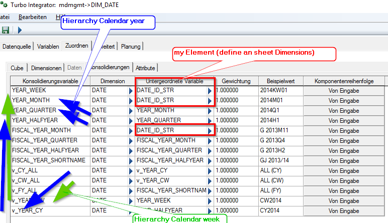

Then you define this PK as an element and all other identifiers as Consolidation (my pic stems from a german installation, but it's named similar I think; Anderes means other):
Now you define the parent-child-relationships on sheet Consolidations:
There is no drag-n-drop-area per hierarchy like Transformer offers one. The relationships you define make up the hierarchies you get.
Then you also define Attributes and can generate the dimension. You receive not one ALL element, but as much as you created hierarchies. This means you need to be aware of this when aggregating data: This can be done only along of one of your hierarchies!

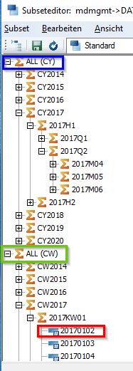

Here the result in the Subseteditor:
It seems like I could add only max. 3 pictures per post...
Note, that I prefixed the year level members (CY for calendar year, CW for calendar week, so furtherly the derived variable is used). When I left the years as they were (e.g. 2016) I got odd results. It seemed that TM1 was confused which year belongs to which hierarchy due to the occurance below of both. Prefixing them avoided this and everything worked. I can't preempt that I made a mistake somewhere else, but if you see an odd distribution of members which are used to build more than only one hierarchy, this could be a solution.

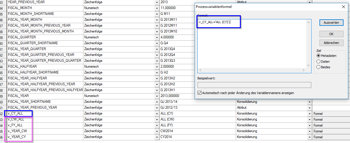

The ALL members I created artifically (string formula), as these were not included in the ODBC source:
