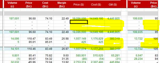

My team is switching from Hyperion ESSbase, and they are familiar with an ESSBase feature where the a cell with missing data (Null Data) can default to a replacement string - typically the value "0".
So in the excel PAX tool, on 10.2, unless they wrap the TM1 Function call in an IF or similar structure, they don't know how to automatically place 0's in the Excel Cells with the NULL Data.
Does anyone have a solution that would work directly with TM1 or with the excel PAX (formally CAFE) addin?

by ssproul
I am pretty Sure that the underlying element Type is a numeric value.
Showing Blanks.PNG (132.46 KiB) Viewed 12644 times

Looks like Excel formatting to me. If you notice the columns that display blanks are formatted differently than the others. Show me a a straight slice and I'll think otherwise.

Re: Missing Data showing as Blank in EXCEL. How to Default to "0"
Posted: Tue May 30, 2017 10:04 pm
by jim wood
TM1 numeric elements always display as zero when not populated in the cube viewer and will display as zero when sliced in to Excel. What you do within Excel is something different. What I mentioned was String Elements. They display as blank when not populated with any data.

by declanr
By default pax uses the formatting set within TM1; this is then just excel so it can be changed in excel.
To set the default in TM1 just use the "format" in the measures dimensions element attributes.
Again you enter this as you would excel formatting so choose custom and then:
#,##0.00;[red](#,##0.00);
This would format zeroes as blank due to the third part (aka after the second semicolon.)
But this will just be the default, users can then still change it to whatever they want in excel.
Posted: Wed May 31, 2017 2:05 am
by whitej_d
Another thing that was the case in 10.2, not sure since, is that if you have "undefvals" in your rule it tends to return blank vs zero in excel. For cells which have had a number, but it was then deleted, it will return 0. It then plays all kinds of havoc with zero suppression. Up to 10.2, performance modeler would automatically add undefvals to all cube rules. I don't think it does anymore, but I'm not completely sure. Removing the undefvals would make blanks default to zero in every case as per original tm1 behaviour in versions of old.
