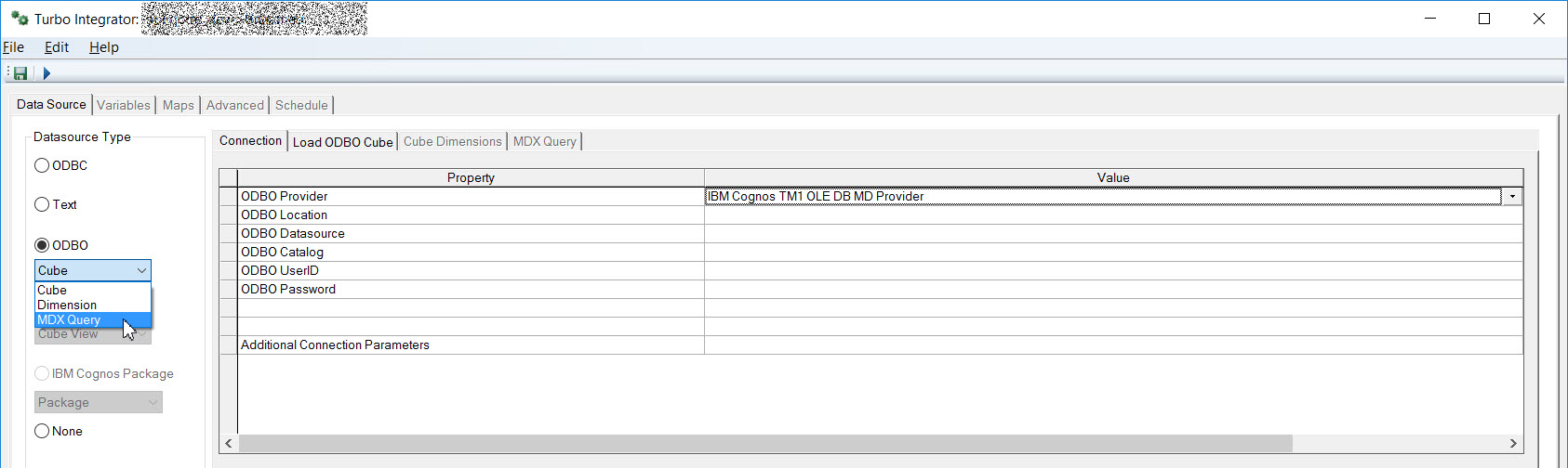

Ah, I see: I always thought of the Datasource type ODBO as a connector made only for pulling data from MS SSAS Cubes (if I remember right, it was also called somehow like that before 10.2). But if this works also for retrieving data out of TM1 cubes into external databases, this would fit best for me. Thanks for the hint.
The ODBC-path I'm using also for pulling data into TM1. But for pulling TM1-data from an outside load target (e.g. ETL), I need to install a TM1 ODBC driver on this external machine. Into the TM1 setups I didn't find a setupfile for the ODBC-driver... separate download @IBM? Install & Operations manuals don't really tell... Or do I need to install TM1 also on the ETL machine just to have the ODBC-driver there?

st2000 wrote:The ODBC-path I'm using also for pulling data into TM1. But for pulling TM1-data from an outside load target (e.g. ETL), I need to install a TM1 ODBC driver on this external machine. Into the TM1 setups I didn't find a setupfile for the ODBC-driver... separate download @IBM? Install & Operations manuals don't really tell... Or do I need to install TM1 also on the ETL machine just to have the ODBC-driver there?
It is installed automatically as part of the TM1 client install. For many years after the Cognos and IBM acquisition it continued to be called the Applix OLEDB Provider but I notice now that it is called "IBM Cognos TM1 OLE DB MD Provider" in 10.2.2.
There might be a separate install available but the easy way is to just install the client.
