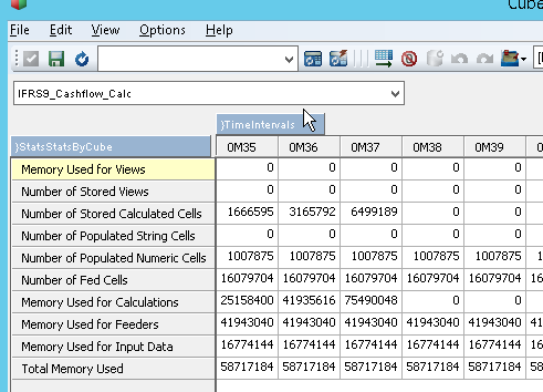

VMT = 1, VMM = between 1,000,000 & 2,000,000 depending on cube just to be safe.
Stored calc cells & memory used for calcs drops off as soon as view is rendered, and it never caches.
Screenshot attached as well
Cheers
Cheers
- TM1.png (20.32 KiB) Viewed 6981 times

Second Recalculation results in a full recalculation – effectively no caching of the previous calculation, for any cube in the instance, regardless of the VMM/VMT settings.
There has been no change to the underlying data.
In effect at 0m38 above, the view is rendered and the system appears to dump the memory.
We have been running on 10.2.2 FP6/FP7
