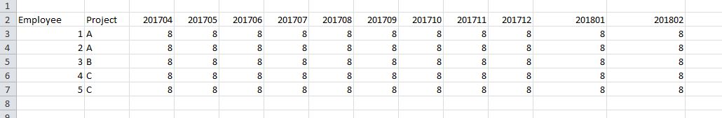

i am having data in following format.
the columns in yyyymm format is measure i.e. employee working hours. these columns are dynamic means data is available for 8,9,12 up-to 24 month.

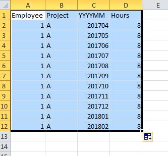

my cube have following dimension Employee,Project,Month,Measure dimension(hours) because of uncertainty of month columns i need to convert this file in below format and then load.
is there any way that i can directly use the original file to load the data? one way is to involve ETL team to load these files in database and then load it to TM1 but i want to achieve this in TM1 any .vbs or .bat utility can also work who can transpose the file in desire format.

Just create a "sample" file, that has all 24 months in it, and use that to create your code. You can leave the column names as you have them as the variable names (put a "v" in front as TM1 doesn't like numeric only variable names). Then you write 24 CellPutN statements in the Data tab:
CellPutN(v20174, Employee, Project, '20174');
CellPutN(v20175, Employee, Project, '20175');
CellPutN(v20176, Employee, Project, '20176');
CellPutN,,,,,,,,,,,,,
If a row in the file has less than the 24 months those variables will be empty, which should be OK. If not then just wrap each CellPutN in an IF statement that only puts when the data is not zero.

Thanks for the suggestion , one more thing i forgot to mention these months are dynamic it will change as we move ahead so coding variable name as month will give data error in future.

If your period date always within a given time frame? In other words, the source data will never contain data outside of a 24-month period during a given fiscal year/etc? If so, structure your time dimension as 1-24 (or 36, or whatever) and use an alias for the actual periods you are dealing with at the time (201701, 201702, ...) and that way you do not have to modify code, just the aliases when appropriate.

I would use a sample file as Tom wrote.
Execute the process with a parameter for year and period.
Depending on these parameters determine the real calendar periods and do a zero out and cellincrentn.
If you use V1 to V24 you could make it all dynamic in a loop and use Expand.
