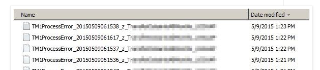

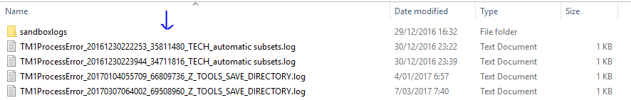

The TM1 process error logfiles appear to have a random number since the last version of TM1.
In the past we had:
http://everanalytics.blogspot.be/2015_0 ... chive.html
Now we have:
Just a note: for those using WildcardFileSearch or DOS commands to loop through log files, just make sure you incorporate this change if needed.

Hi Wim,
I think this is a good thing for multi-threaded environments. I've had issues in the past with the same TI running at the same as itself trying to write to log files owned by its "twin" and erring out because of this. Took a bit of head scratching to figure out was going on.
