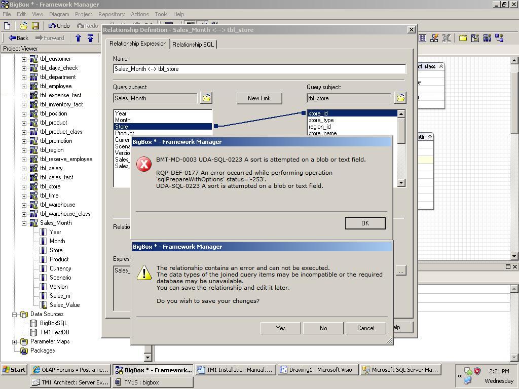

I'd like to ask if anyone tried using TM1 data other than the Portlet provided by Cognos BI for TM1 but importing all TM1 cube data to a database and using it create relationship with an existing Database.
I used the a database from a MS Access and imported to SQL. Then I created te data source in Framework. Then using tables from MS Access I creates cubes in TM1 and then used ODBCOuput export data to a datasource before connecting it to Framework. When I was creating relationships I got this error prompt
Initial error during relationship creation between MS Access against TM1 data in MS SQL

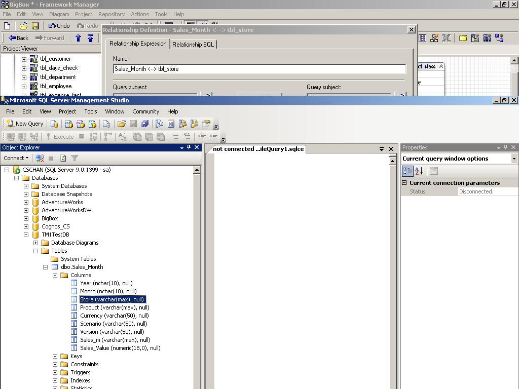

I tried testing the exported TM1 Data...and I'm aslo getting an error. I noticed that both Store & Product that I was creation a relationsip is TEXT BLOB.

I've got to ask....
Why?
Publishing a TM1 cube under Framework Manager will deliver faster results to your users than any other approach. Why push the data into SQL?
