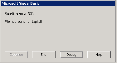

I encountered an issue while running an VB script to refresh and send out an automated report.
When i debug, cursor stop at 'TM1APIInitialize' in the TM1api BAS file.
server : windows 2008 R2
TM1 version : 10.2.2 FP5
excel : office 2010 32 bit
However when i set the excel 'Application.visible = True' in the script , it does not throw an error.
But, i would like to run this script automatically via windows scheduler when user is not logged on or not.
excel setting : "Application.visible = False"
VB script error
VB script error
debug screen
debug screen
Any advise to fix the issue?

I haven't tried to use the API with VBScript (and I don't think you are either; see the last paragraph) but it's dollars to donuts that it has to do with the path to the files not being included correctly in the %PATH% environment variable. This is complicated by the fact that IBM has changed the install path something like 4 frapping times in 5 frapping versions, and that unlike some programs it does not clean up its own merde by updating the Path environment variable upon installation. But hey, the damn thing can't even uninstall a previous version, so...
The issue of setting the path is discussed in chapter 1 of the API Guide if you have the .pdf; if you don't, download it because you'll need it.
I've taken only the most cursory glance at your code but one thing leaps out; if you want this to be standalone code you cannot use TM1_API2HAN. That is only for code that is written in VBA in Excel, and it's for piggy-backing on the user's existing Perspectives connection so that they don't have to log in every time they want to call some VBA API code. Officially the function is unsupported as IBM Support told me when I tried to get it added to the API manual (don't get me started...), but anyone writing VBA code still uses it anyway. However if you're writing it outside of VBA in Excel[1] you need to get the user handle from the TM1SystemOpen function.
(Unless you actually mean VBA and not VBScript - they are not the same thing - which is what it looks like from your code. In any case it won't work if you want to run the thing unattended since TM1_API2HAN depends on (a) a session of Excel running and (b) a user being logged into TM1 inside that session.)
