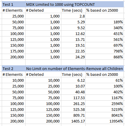

There are at least three things here that still concern me about this requirement:
1) Number of Elements - 250k plus - What I have noticed is that as the number of elements increases, so does the time to deal with them, however this seems to be a geometric/exponential relationship. You would immediately see this issue if you try and page down in the subset editor in a small vs very large subset/dimension.
2) MDX in the recent post - this is creating a dynamic MDX subset, not static
3) If the MDX is effectively getting the children of the parent in question, why would you need to do an ELISPAR/ELISANC again? You have the N level elements in question to delete.
So the code I used (and just saw Wim's post along the exact same lines) is as follows:
MDX = '{TM1FILTERBYLEVEL({TM1DRILLDOWNMEMBER({[' | DimName | '].[' | Parent_Element | ']},ALL,RECURSIVE)}, 0)}';
SubName = GetProcessName() | '_Source';
IF(SubsetExists(DimName, SubName) = 1);
   SubsetDestroy(DimName, SubName);
ENDIF;
#--Create subset via MDX then make it Static
SubsetCreateByMDX(SubName, MDX);
SubsetMDXSet( DimName, SubName,'');
#--Looping from last to first-no need here as we only have N levels but habit
iCount=SubsetGetSize(DimName,SubName);
WHILE(iCount>0);
sElement=SubsetGetElementName(DimName, SubName, iCount);
DimensionElementDelete(DimName,sElement);
iCount=iCount-1;
END;
I then created a process to add elements based on a set of tranches and then delete them again to test what I referred to in point 1 above. I just tweaked the original MDX to limit the number of elements to delete i.e.
MDX = 'TOPCOUNT({TM1FILTERBYLEVEL({TM1DRILLDOWNMEMBER({[' | DimName | '].[' | Parent_Element | ']},ALL,RECURSIVE)}, 0)},1000)';
The results are per this attachment
My conclusion is that the larger the dimension is, the more patience you will need (and probably weekend/overtime to run these cleanups)
Not sure that it hepls your plight but at least explains things.
