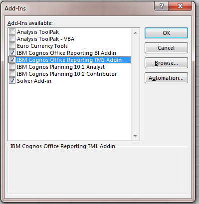

Have you managed to resolve this issue? We have had this many times, make sure that Excel add-in IBM Cognos Office Reporting TM1 Addin is ticked.
If it doesn't appear, you can click browse and add it in again using this path. C:\Program Files (x86)\ibm\cognos\IBM for Microsoft Office\CognosOfficeTM1.xll if you are on a 64-bit machine.
