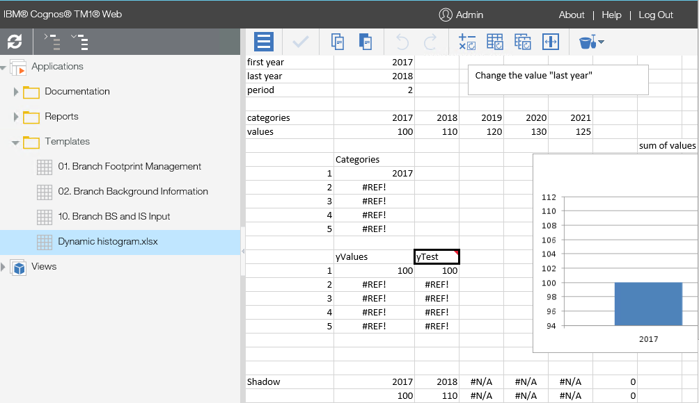

Thanks for the example - I tried a few things without success:
-Changed range's scope from Workbook to sheet
-Referenced Category Axis Labels using the actual cell range, no dynamic range
-Checked the option on the chart to show data in Hidden and Empty cells
I also tried creating a shadow table that returned values from the main table based on the year being within the selection range, otherwise, NA() (btw NA() is a useful way to avoid plots of zero being shown on a graph)
I added a cell reference to the values and categories ranges so that I could see what was being returned-The interesting thing here is that Excel returns the first element in the array whereas TM1 Web returns the last. That being said, changing the "last year" does change what is reported by TM1 Web i.e. the named range seems to be referenced and updated correctly.
I then added two sections, each with an index number to read the values from the array based on index e.g. INDEX(<array>,<indexno>)
This works perfectly in Excel but returns #REF in Web for all points except 1.
Lastly I added a static range and linked it to the INDEX as per paragraph above-all points other than 1 give me #REF.
I am attaching my workings for your reference and possibly other readers who can review and shed some light - at this stage I cannot test any further (work awaits) but looking like a possible bug on 10.2.2 FP4 which I am testing on.
Dynamic histogram.xlsx
George's workings
(13.64 KiB) Downloaded 846 times

Had a moment and thought I would test on PAL 2.0-looks like the issue was not noticed or fixed.
@mihas1001 - suggest you try log an incident. I will also try to raise a APAR this week.
Dynamic histogram_PAL.PNG (54.37 KiB) Viewed 14700 times
BR, George.

APAR Logged and confirmed by IBM:
PI77178-TM1 WEB SHEETS USING THE SUPPORTED INDEX FUNCTION ONLY RETURNTHE 1ST ELEMENT IN THE ARRAY
