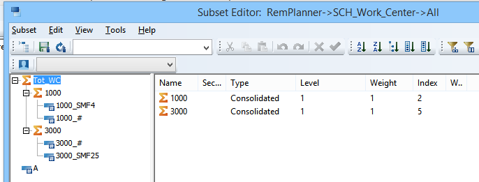

I have a very simple dimension, in fact I deleted everything that is not related to the issue.

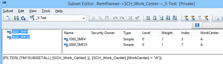

I try to filter out the elements containing 'A' for the text attribute WorkCenter. Pretty easy you would imagine.
If the grandparent has children, then the 2 elements that should be returned, cannot be formed as a tuple.
If I break the links such that the grandparent has no children, then the 2 elements are returned fine.
See pictures in the Word doc please, I could only add 3 pictures I think.

I created the dim per the doc and added a measure called A for "good measure".
Returns the two elements as you would have expected. This is on 10.2.2 FP4.
{FILTER( {TM1SUBSETALL( [SCH_Work_Center] )}, [SCH_Work_Center].[WorkCenter] = "A")}The difference, besides versions, may be that I do not have the dimension associated with any cubes, or any other dimensions with an alias containing a text attribute with values of "A" (I did add an attribute to an existing dimension to test this case too-no issues elements returned as expected).

- Dim Filtered using MDX
- SCH_WorkCenter_Filtered.PNG (23.83 KiB) Viewed 3460 times
