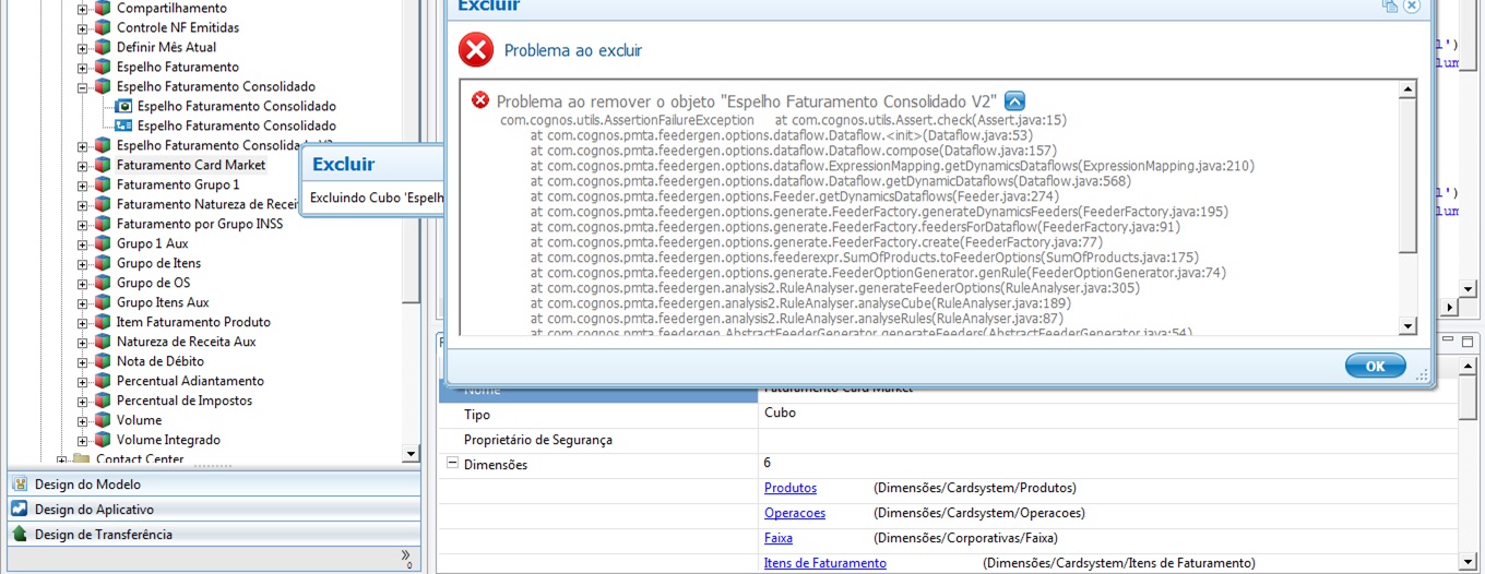

I am facing problem when I am trying to delete some cubes on Performance Modeler.
Can anybody help?
Find attached file with error.

Performance Modeler simply kicks of a series of TI processes. They are hidden as control objects. The first thing I would do is make sure that they are still in place and you're able to access them,

I have checked the log file and the problem is:
4304 [34] ERROR 2017-01-20 11:20:21.891 TM1.Mdx.Interface Syntax error at or near: '[}CubeCaptions]', character position 90
4304 [34] ERROR 2017-01-20 11:20:21.923 TM1.Mdx.Interface Syntax error at or near: '[}CubeCaptions]', character position 90
4304 [34] ERROR 2017-01-20 11:20:21.923 TM1.Mdx.Interface Syntax error at or near: '[}DimensionCaptions]', character position 90
4304 [34] ERROR 2017-01-20 11:20:21.923 TM1.Mdx.Interface Syntax error at or near: '[}ElementCaptions]', character position 90
4304 [34] ERROR 2017-01-20 11:20:21.923 TM1.Mdx.Interface Syntax error at or near: '[}CubeCaptions]', character position 88
3320 [35] ERROR 2017-01-20 11:44:09.596 TM1.Process Process "}_intDPD_CallFeederGen_{2b3064a3-8c7d-4f24-a3d8-8de10d23be79}": : Execution was aborted. Error file: <TM1ProcessError_20170120114409_}_intDPD_CallFeederGen_{2b3064a3-8c7d-4f24-a3d8-8de10d23be79}.log> : Errors occurred during execution of process "com.cognos.pmta.feedergen.standalone.GenerateFeeders". Check error log file for that process for more details
So I did a test. The model was set to generate automatic feeders for rules and links. I tried without generating automatic feeder for rules and it worked.
I do not know what is happening, but this is the only way that I can keep working with rules on performance modeler. In this case I have to do feeders manually.

Re: Deleting cube on Performance Modeler
The only way I can work on rules with performance modler is to not use performance modler.Jorge Rachid wrote:So I did a test. The model was set to generate automatic feeders for rules and links. I tried without generating automatic feeder for rules and it worked.
