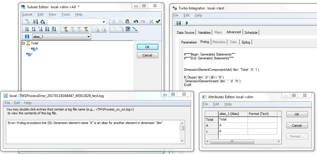

I have a strange situation in TI with a very simple dimension, simplying further is not possible.
This code in the Prolog gives an error on the line with DimensionElementInsert, saying that the element that I want to insert already exists as an alias. This is correct.
But if I comment out the DimensionElementComponentAdd code, the Dtype function is honoured and the code continues without error (and does not try to insert the element).
DimensionElementComponentAdd( 'dim', 'Total', 'A', 1 );
If( Dtype( 'dim', 'd' ) @<> 'N' );
 DimensionElementInsert( 'dim', '', 'd', 'N' );
EndIf;
Howcome......... ?
I know that using Dimix = 0 would be better than Dtype @<> 'N' but still, why does this happen ?

Hi Wim,
From what I can see using a quick asciioutput, it looks like an inconsistent behaviour with the temporary dimension.
If you make a change to the dimension, the temporary dimension is created and used for the Prolog changes. The DType does not seem to resolve d=c and thus DType=N.
An ATTRS('dim','d','alias_1'); does however resolve to c which in turn returns d.
Moving the DimensionElementComponentAdd below the IF(DType...) section is as good as hashing it i.e. temporary dimension not created yet.
Setting a variable to the principal name e.g. sEl=DimensionElementPrincipalName('dim','d'); and then using sEl in the DType function seems to get around this.
Looks like you have discovered an obscure bug though as other functions behave as expected.
BR, George.
