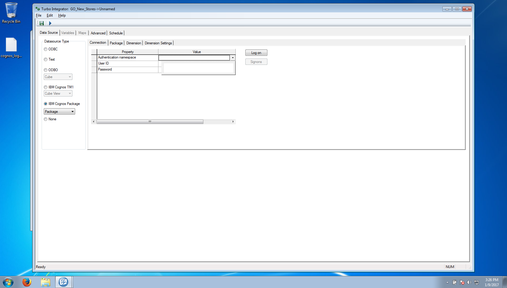

I'm having an issue with getting a TI process to use a Cognos Package as a data source. I'm setting up a brand new Windows 7 64 bit VM with TM1 10.2.2 FP5 and Cognos 10.2.2 (no fix pack), both 32 bit. I installed Package Connector in the same directory as my Cognos 10 instance. When I go to create a new TI process, the "IBM Cognos Package" radio button is enabled, but when I click on it and try the dropdown for Authentication namespace, I get an empty container:

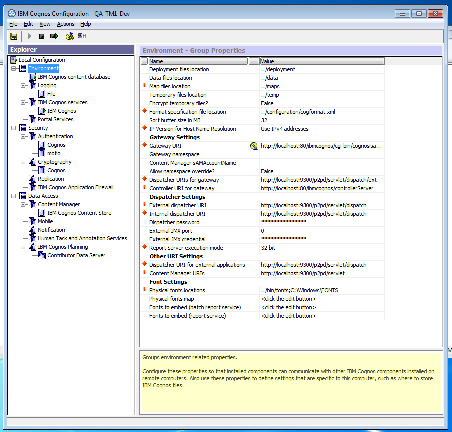

And now I am fresh out of ideas. I'll post a couple of screens of my Cognos Configs below if it will help. Any ideas on this would be greatly, greatly appreciated.

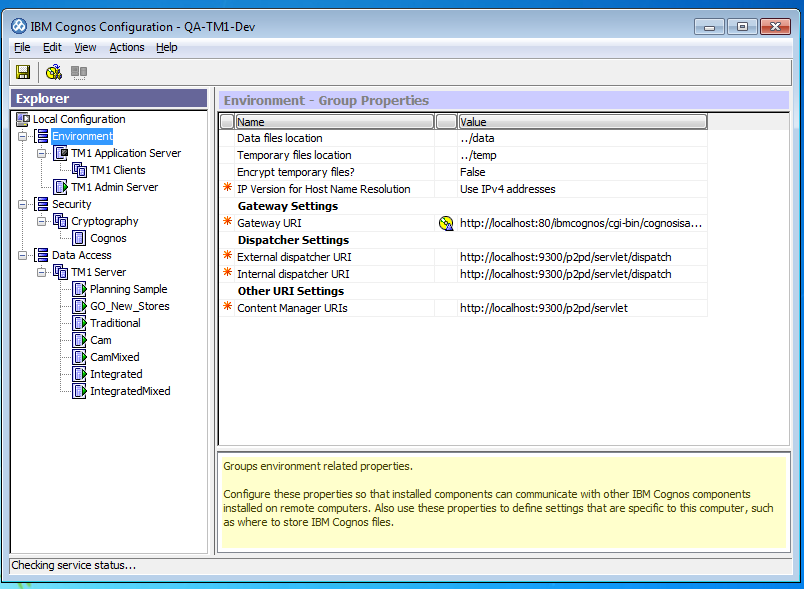

Screenshot of my Cognos Config Environment:
Evan

Screenshot of TM1 Config Environment:

For anyone reading this with a similar issue, I did finally find a solution. After installing an Active Directory namespace to my Cognos instance, I went back and opened a new TI process with the Cognos Package datasource, and the namespaces populated just fine. In fact, once I added the AD namespace, both the AD namespace and the CAP namespace showed up in the TI namespace list. So package connector was most likely never broken in any of the configurations I had.
If someone has this problem in the future, especially if you see a the dropdown box that should have namespaces but is empty, your namespaces are most likely the problem, not package connector.
