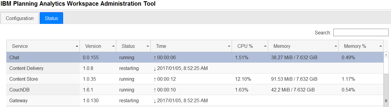

I had PAW up and running in my Linux CentOS environment. For some reason I cannot connect any longer. I have restarted the VM and the Admin Tool and get:

I have tried stopping and restarting the services via the paw.sh script - the services go back to restarting with the mdkir -p
I saw a reference to /var/log/harmony - created it and gave permissions - no change
Any ideas?
