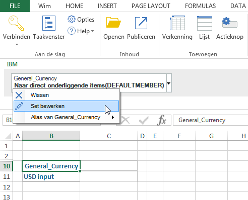

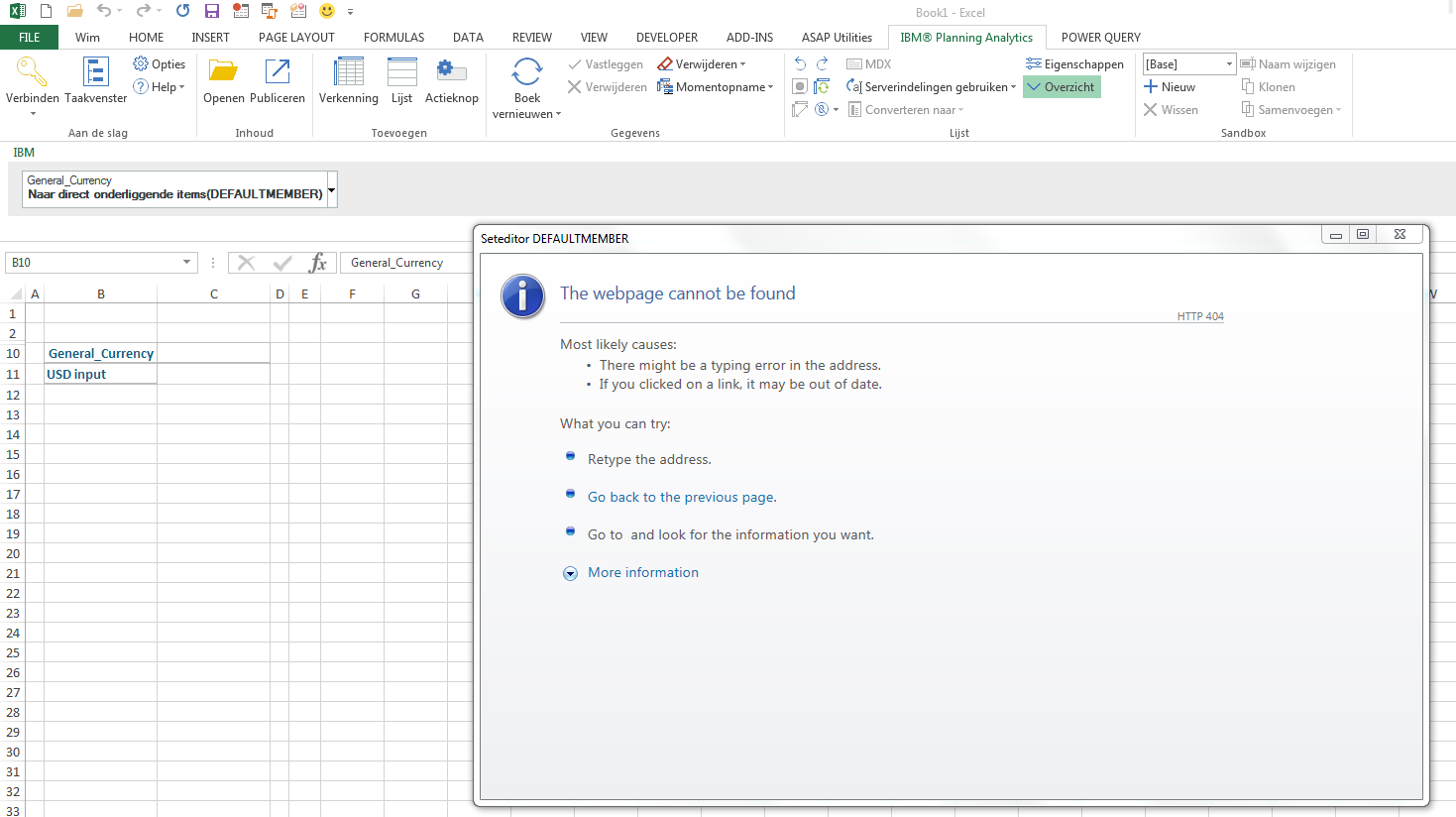

Hello all,
For me, the Subset Editor cannot be shown when trying to change an element / set. Any ideas why ? Do I need to change / configure something ?
Does it require that PAW is installed (which isn't the case now, only the TM1 server and its clients)
It's all locally on my laptop. The connection URL is http://localhost:9510

Might be wrong but think you have hit the nail on the head; I am fairly sure I read somewhere that one of the reasons you need to install PAW even when not using/licencing it is so that you can use features like the subset editor in PAX.
Re: PA for Excel - subset editor
declanr wrote:Might be wrong but think you have hit the nail on the head; I am fairly sure I read somewhere that one of the reasons you need to install PAW even when not using/licencing it is so that you can use features like the subset editor in PAX.
Thank you Declan. So let's first try to get PAW installed then.

I suspect that you are thinking of the post by the redoubtable Mr. Rowe here.

Yeah, this is the problem we encountered too and i posted in another thread which Steve replied. Not sure why PAW is needed. Perhaps multi hierarchy feature is managed from PAW instead of TM1server?
