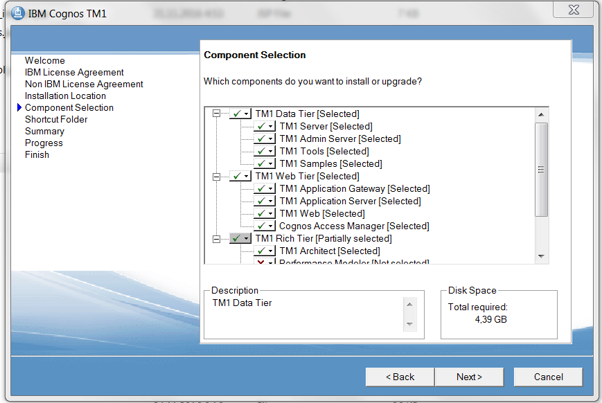

I just installed Planning Analytics Local on my PC and checked TM1Web option in the beginning of installation.
However, I cannot see Application Server in Cognos Configuration and respective Windows Service is not listed either.
Am I looking for something that does not exist in Planning Analytics at all?

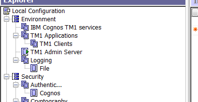

- Posts: 1833
Re: Planning Analytics Local 2.0 - Where is TM1Web?
Under "IBM Cognos TM1 Services" there should be an "IBM Cognos TM1" which appears to he the new TM1 web service/app service. It should have been selected by default when installing but looks like you didn't get it. Try running the installer again and make sure its selected.
Note TM1 web has had a makeover but for the most part still functions the same.

Thanks for your prompt response!
I uninstalled and re-ran the installer and made sure that that TM1Web is checked but no change - Cognos Configuration looks still the same.
What could it be? Some missing software requirement on my PC?

- Posts: 1833
Have you checked the install log to see everything completed ok?
Don't think I needed to but just check that right clicking on "IBM Cognos TM1 Services" doesn't give you a start option... like I say fairly sure it doesn't but might be a start to create the service job.
Yep, there it was. I had to create "a new resource" under "IBM Cognos TM1 Services" and now I am able to see TM1 web login screen. Cannot log in but need to invest more about config etc.

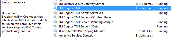

Hmmm,
Here are the services i have, I think the highlighted one is the app server but can't be sure.The settings for the TM1 environment are on the "TM1 Applications" screen in CogConfig. I have a PMR open and was told that the settings on the Environment tab were not relevant to the TM1 services, that they were related to Cognos Analytics. Why its like this I can't say, but i spent quite a bit of time trying to get Web and PAx connected on 9300.
