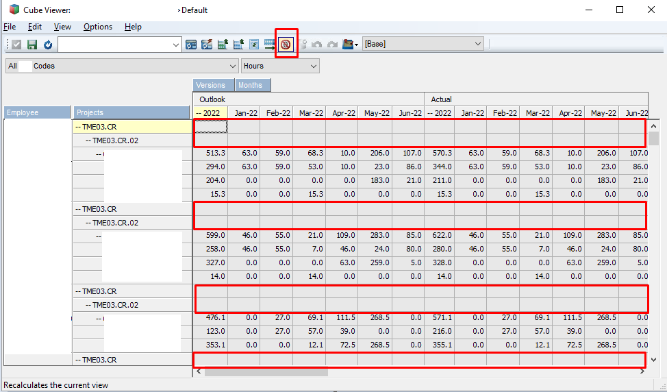

I am having the same issue and hope it was resolved. Can someone please let me know what the issues could be? Admin users can see the rollup numbers and non admin group cannot.
We have a contributor application and manage-rights security is on Projects dimension. This part works well. I have also created an alternate hierarchy rollup to be used in perspectives where users are having the issue. I have given users 'WRITE' to the intersection and they see blank.
In the pic I attached, zero suppress is on. Users can see the blank-intersection. Any ideas?
Paul.

This looks like you have both element security on the Projects dimension where the users have at least READ access and cell security rules on the cube in question which are giving NONE access to the consolidations in the Projects dimension.

Thanks Lotsaram! After I added the cell security, it worked like a charm.
