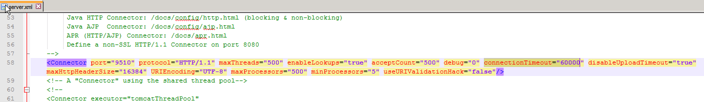

I am not quite sure coz I can't find anything useful but just came cross this configuration in tomcat server configuration file. Has anyone known this about? If I make it longer, does that help? Since the overall symptom is just like timeout for me.
