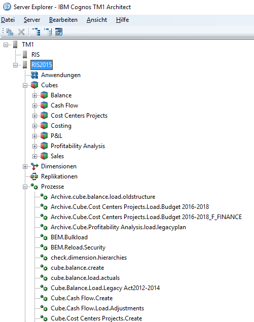

As an example this the Architect-View:

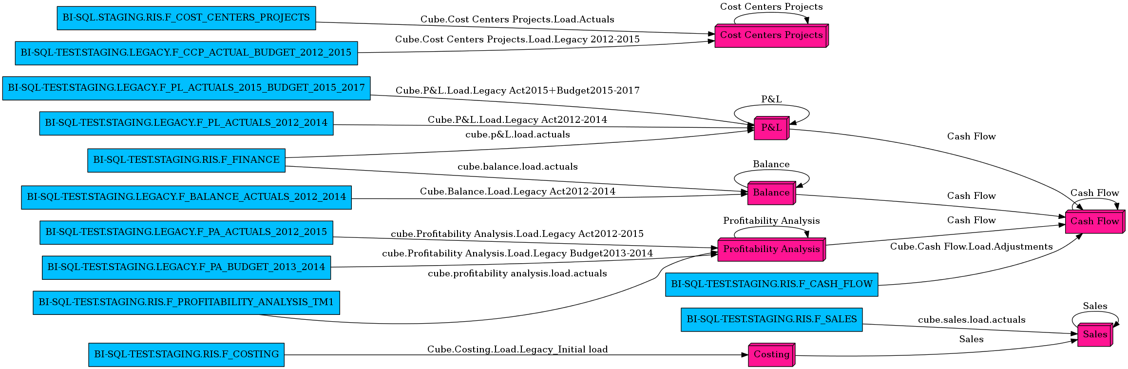

My tool can create (among others) this image:
(blue = ODBC tables, pink = cubes)
Modifying the style of the ouput graph is very simple if you don't like the colors.

A query on your system diagram, does your tool get to the layout shown automatically or have you rearranged the boxes post generation? I have seen many tools that could graphically document the links but very few (if any) that get to a sensible arrangement.

@ Steve: the layout is created by graphviz. You can use all the generators, I prefer dot for this, because it captures the hierarchy nicely. My tool will simply output a string that is piped into graphviz. There are a lot of ways to configure the rendering process.
