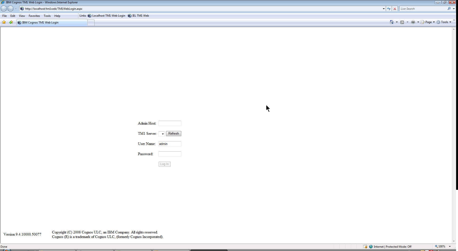

I have this issue that has been bugging me for the longest time. I have the full TM1 9.4MR1 installed onto my PC, which is running on Vista Home Premium. It has IIS, Excel 2003 and .Net 3 installed too.
I have not been able to run TM1 Web as a localhost successfully.
First Problem:
Initially, I was able to login to TM1 Web. but i was unable to open an Excel report in Web despite the Excel Service running. it seems to fail to convert Excel into XML. I opened Windows Services and checked the properties of TM1 Excel Service, and it shows the path to executable is pointing to tm1_service_launcher.exe. This is odd as my colleague's setting is pointing to Excel service!
could this be the reason of the failure to convert to XML?
Second Problem:
Thinking that the 1st problem was due to an installation error, i proceed to reinstall TM1. this turns out to be a disaster. Now, when i try to access the login pag on localhost, the whole page is screwed (see attached). No pics are displayed, except for the text boxes. if i login, i will only see a minimally displayed left frame.
Anyone knows the root of the problem? Is it due to Vista Home Premium? I have already disable User Control feature before reinstalling but to no avail. the funny thing is, TM1 Web was working initially but Excel service failed a couple of months back... totally weird.

- TM1Web localhost.jpg (104.6 KiB) Viewed 12717 times

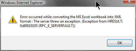

FYI, i added all possible users in DCOM for all Security options and still the error occurs... i will post the image of the error message so that we can confirm we are hitting the same problem.
here is the image:
here is the image:
- TM1 Web Excel error
- TM1Web Excel Error.jpg (12.46 KiB) Viewed 12506 times

8) Go to Security tab.
9) Go to Configuration Permission and add "Network Service".
10) Go to Identify tab and select "The interactive user".
11) DOne. You can test it out using http://localhost/TM1Web/TM1WebLogin.aspx.
manage to get Web AND Client working on Vista Home Premium. I took your recommendation on updating the Identity tab. But instead of change to "This User", I changed to "The Interactive User" instead.
Give it a go and see if it works for you.
To summarise (for those who are troubleshooting):
1) Not sure if Vista's irritating UAC affects the installation process, but i just leave it on anyway.
2) I go to Properties of the setup.exe file and set it to run as an Administrator.
3) After I install Vista, I intentionally enable IIS in Windows Features FIRST. I reboot and then enable .Net Framework.
4) As an added measure, I set up FULL Control on C:\inetpub folder as well as the folder where the project's files are located for "Network Service".
5) I was told that Microsoft updates on ActiveX Killbits will screw up TM1 Web, so I skip that update. Likewise for Security Update KB960715. However, I realise my Vista has never installed KB960715. Anyone has more info on this, please share.
6) I finally install TM1 by running the setup.exe as an Admin.
7) Next, as per Michel's recommendation, access DCOMCNFG using DOS prompt. Go to Computer Service > Computers > My Computer > DCOM Config > Microsoft Excel Application. Right-click "Properties".
