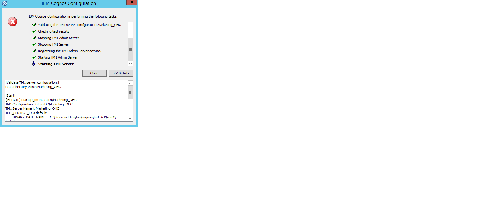

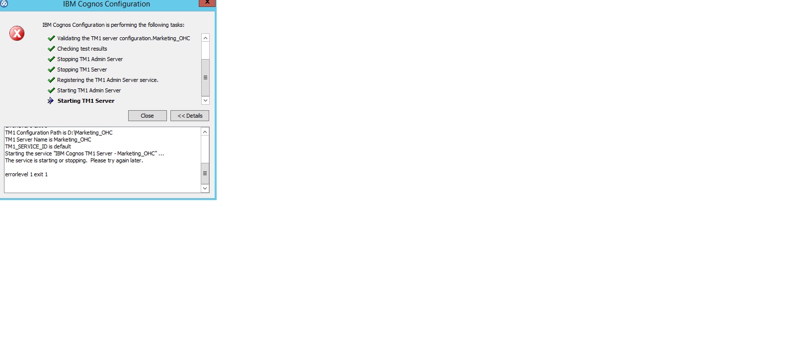

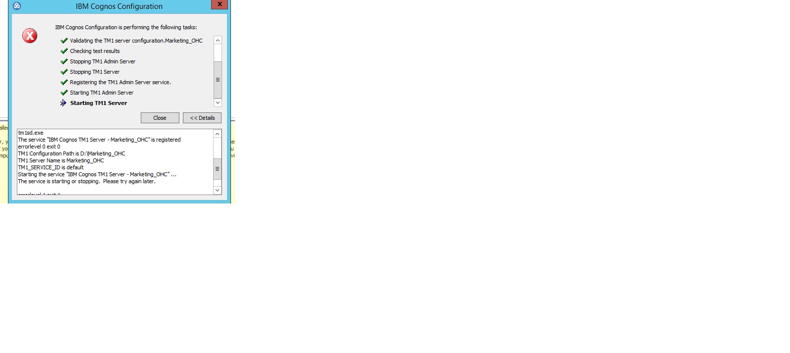

HI Gurus, W have successfully updated the SSL certificates in our UAT environment. Post upgrade when I try to stop TM1 admin server it is giving me an error (Please see the attachment).It showing always in start mode.I have also try to shut down by going to services to no avail.

Is it something to do with it ? Our window admin says he can cludge the process,It is sort of force shut down,I am not sure what sort of troubles it would lead to if we do that.
I would appreciate if someone let me know the way out of this , What steps needs to be taken to fix the issue? Thanks
