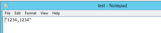

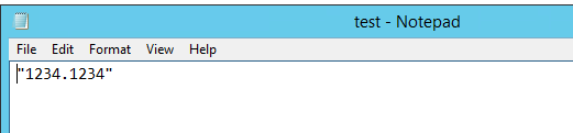

TI process:
lf = 'test.txt';
AsciiOutput(lf, NumberToString(1234.1234));
Results:
I run the process on the server with US settings, it gives me 1234.1234
I run the same process on my client with Dutch settings, and it gives me 1234,1234

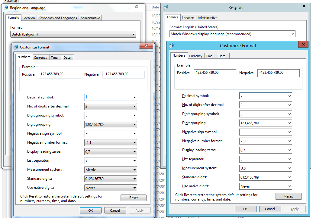

See screenshots. The client with Dutch regional settings is on the left on the first picture, and also on the 2nd picture.
The server with US settings is on the right on the first picture, and also on the 3rd picture.
