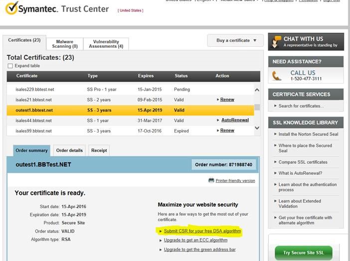

I contacted Symantec and they sent over instruction for what I will need to do. I have not done this yet but wanted to share here. I will be testing it out this week.
INSTRUCTIONS:
So what you will have to do is purchase a Secure Site SSL certificate, once you have placed the order you will have created a Trust Center.
Once the certificate has issued you will have a certificate with the RSA Algorithm which you can use for the encrypt key pair.
The trust center will give you the option of getting a free DSA algorithm certificate as seen highlighted below:
PIC Attached:
Follow the prompts from there and you should have the 2 certificates that you require.
Pic for Instructions
INSTRUCTIONS:
PIC Attached:
This did not work!!!!!!!!!!!!!! but I found a solution and added it to a different topic.http://www.tm1forum.com/viewtopic.php?f ... 120#p63119
