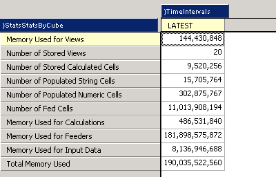

Here is a current snapshot of the }StatsByCube for the source cube (I warn you, it's not pretty):
We are looking into alternative designs, potentially a TI driven solution rather than a rules driven solution, but the client has a strong desire for real-time calculations so rules were the obvious choice when the system was being designed a long time ago.

Your stats do look like there is some massive overfeeding going on
How exactly do you see that from the stats table? They have ca 36x so many fed cells as numeric. so what if there are 36 currencies calculated from local currency with rules :D
I understand that from earlier posts it turns out it may be an overfeeding, maybe TI or implicit C: feeders would help, but I'm not sure how you see from the screenshot that it's overfeeding? Do i miss smth obvious?

mvaspal wrote:How exactly do you see that from the stats table? They have ca 36x so many fed cells as numeric. so what if there are 36 currencies calculated from local currency with rules :D
No, of course I can't be sure there is actual overfeeding. But when I see a 36-to-1 ratio of fed cells to populated cells then to me it's definitely a red flag. Sure, there are cases where that feeder ratio will be perfectly justified, but honestly if I had a model that is as feeder-heavy as this I would redesign it.
The rule of thumb we use to identify "suspected overfeeding" is 20x
Whether something really is overfed or not depends on the model. Sometimes, especially for allocation type models there is no alternative to overfeeding because there's no way to know ahead of time where the drivers will be. Although 20x is the rule of thumb to identify overfeeding normally I wouldn't be too bothered by anything much under 100x. Except that in this case I would be. We're talking about a cube of 190 GB in memory of which 180 GB is feeder flags. I can't imagine how performance could be anything other than barfworthy. For a data model of this size you have very different optimization parameters and design constraints that a cube of 100 MB. And one of the most significant constraints is that over very large datasets the order of magnitude difference between rules & pure data aggregation adds up to unacceptable performance in a rule heavy model (although MTQ is changing that).

lotsaram wrote:We're talking about a cube of 190 GB in memory of which 180 GB is feeder flags. I can't imagine how performance could be anything other than barfworthy. For a data model of this size you have very different optimization parameters and design constraints that a cube of 100 MB. And one of the most significant constraints is that over very large datasets the order of magnitude difference between rules & pure data aggregation adds up to unacceptable performance in a rule heavy model (although MTQ is changing that).
The performance in the cube itself is not terrible. I'd estimate that somewhere in the area of 120 GB of those feeder flags are actually feeding the virtual cube, so the stats are misleading as to how much memory is being consumed for feeders inside the source cube vs feeders to the virtual cube. Switching the design to use TI instead of rules to populate the "virtual" cube may be the way to go for a dataset this large.
