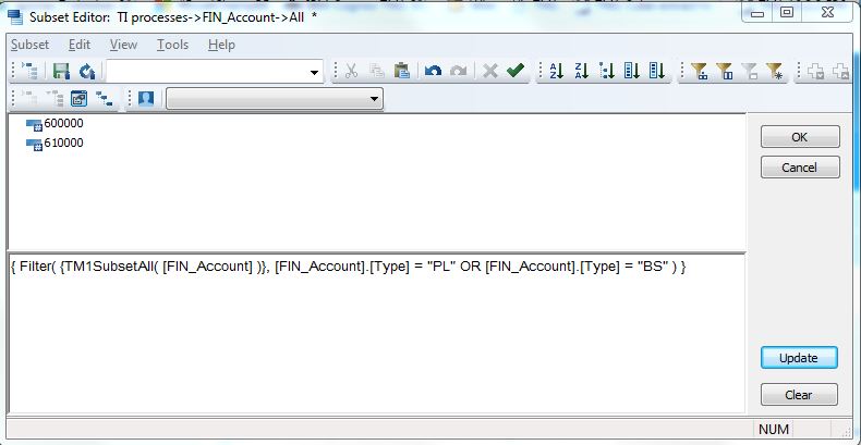

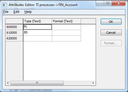

No Tom, it works just fine. I have an example on my website but here's a visual example.tomok wrote:To the best of my knowledge, there is no AND operator in MDX. This is why it is failing.
Both AND and OR work.
