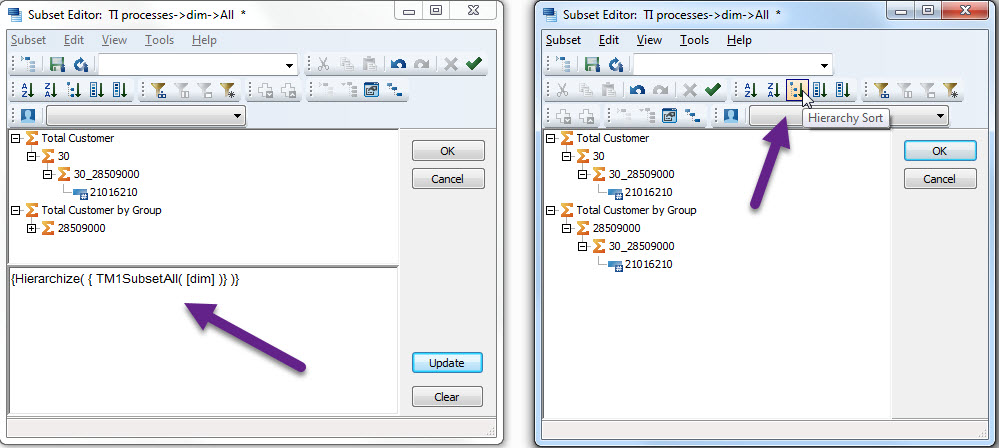

When we record an MDX expression for the button "Hierarchy Sort", the generated function is {HIERARCHIZE( ... )}.
However, there is a difference in case elements occur more than once.
Pressing the "Hierarchy sort" shows all elements in all of their occurrences.
Using for example:
{Hierarchize( { TM1SubsetAll( [dim] )} )}
gives as all elements but those instances where the same elements occur more than once with the same parent-child relation. An example will make it clear :-)
I attach a very simple dimension (*.dim file).
On the screenshot we see the difference between MDX (left) and pressing the icon (right).
Question: what MDX statement/combination of MDX'es can give us the result on the right in this dimension setup ?
Thanks a lot !

Re: Hierarchy sort and Hierarchy MDX
Is just wrapping an all recursive drill down member not sufficient? Or are you looking for just one function?
Great ! That does the job nicely Declan. Thank you.
{TM1DrilldownMember( {Hierarchize( { TM1SubsetAll( [dim] )} )}, ALL, Recursive)}

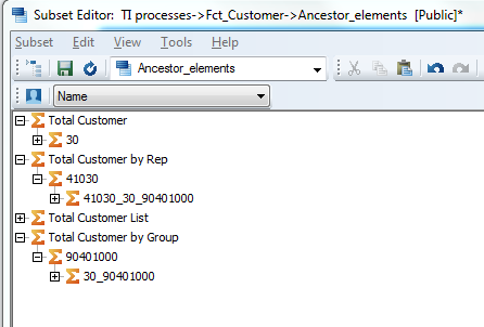

However I am afraid that my query is not solved yet. Let me make the distinction between "icon Hierarchy sort" and "Hierarchize() MDX" clear with screenshots.
Here is a subset, just static, nothing fancy:

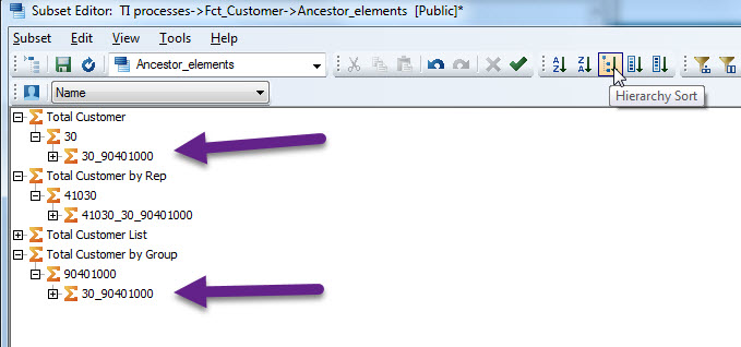

Then I click on the icon "Hierarchy sort", note that the consolidated element 30_90401000 shows up twice. This is the desired result I would like to obtain, starting from the existing static subset, with an MDX expression or combination of MDX functions (does not matter):
My attempt with "Hierarchy()" as this is generated with the expression recorder, note the missing consolidation 30_90401000:
Functions like TM1DrillDownMember are not the solution, because then I receive thousands of customers for free ;-) but I do not want these.
I have the correct elements, but not all instances of them. Of course, this is because of the double usage of the same consolidation.
Thank you Tom, I will experiment with that code and in parallel I will write my own MDX/TI routines.
Wim

[tmp_ty].members
seems to return the subset you were looking for originally by the way.
Ty
Cleveland, TN
PavoGa wrote:Wim,
[tmp_ty].members
Hello Ty,
Can you apply Members on a subset ?
Because I am after a function or functions that can show the hierarchical representation of ALL ancestors of a given element.
Even if the element and certain ancestors occur multiple times in the dimension.
I am not missing something I do not see a way to apply Members on a set of ancestors, to hierarchize them.
PavoGa
Posts: 624
Excel Version: 2013 PAW
Post by PavoGa »
So in my example, you would want to see the hierarchies for say, just Georgia and Alabama?
Ty
Cleveland, TN
PavoGa
Posts: 624
Post by PavoGa »
Sorry, Wim, I see now what you're wanting. Say, given "Coy", you want to see the hierarchies Coy is a member of represented fully from the top to Coy. Hmmmm, tricky...
Ty
Cleveland, TN
