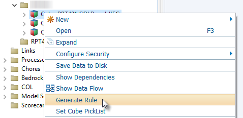

In step 3, I have checked the rule in region "Region N-Calculation rules:" (Picture 1.png) is not updated from attribute 'calculation'.
Rule in cube (As I understand line 6 to line 68 generate automatically)
Picture 1.png (104.84 KiB) Viewed 3031 times

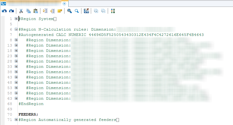

I try to right click the cube and then choose "Generate Rule" with "Performance modeler" (Picture 2.png) and cube rule is updated same as attribute and data in the cube are correct.
Generate Rule with Performance modeler
Picture 2.png (22.44 KiB) Viewed 3031 times
I need to help from everyone, What is TI function name to "Generate Rule" same as "Performance modeler" tool.
