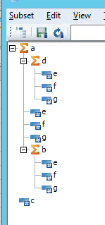

against this dimension
but an empty set is incorrectly returned.

By "duplicates within a consolidation" I assume you mean ultimate descendants of a rollup appearing multiple times and not direct children?
This is the standard MDX snippet I use for this purpose. It will work for the example you gave and return a set of e,f,g for the rollup a
