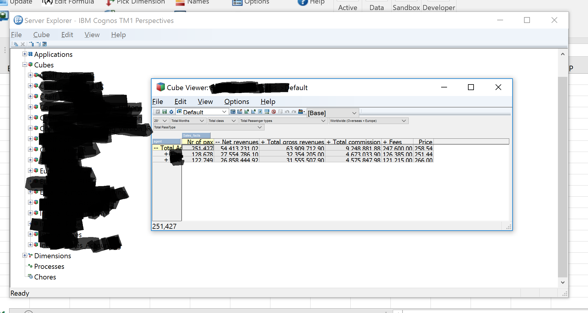

Dear everybody,
I'm tasked with installing tm1 client installations for my organisation. Currently we have upgraded everybody to windows 10.
Tm1 perspectives version 10.2.2 fp4 (64bit) works fine with windows 10 and office 2016 however we've encountered an issue on some laptops which we havent been able to resolve.
The issue is that on some laptops with high resolution panels the numbers in tm1 perspectives cubes get misalligned with the table itself. (see image)
TM1 problemEDITED.png (169.95 KiB) Viewed 38038 times
I'm guessing this problem has something to do with unproper scaling of the cubes in Windows 10. I have already tried adjusting the scaling level up and down and adjusting the resolution unfortunately neither has resolved the issue.
Could someone please provide me with other possible solutions? Thanks in advance!
Greetings,
Wolfs

This isn't a windows 10 issue but simply resolution. Simply Perspectives & Architect are not built for high res. Any resolution higher than Full HD (1920x1080) and you get the issues with fonts too large and truncated looking row highs in the cube viewer and all the icons becoming so tiny they appear to be not more than a few pixels. The only reliable solution I have found is scaling the notebook resolution down to full HD.

I have a surface book for when I am on the move and have the same issue but due to the weird screen perspective there doesn't seem to be a scaling that works. Some make it a bit better and some make it worse.
I just put up with it; luckily I rarely let users have perspectives as an interface. And I still have another machine for when I am at home.

Unfortunately i haven't been able to fix it yet. Even when lowering the resolution the formatting of the table stays the way described in my first post.
If anyone has tips or ideas on what to try i'd be happy to hear them!

Well in the end the solution proved to be lowering the resolution to 1920x1080 and then rebooting the laptop. After which i logged in on an administrator account on which tm1 had never been opened before. This proved to help because then tm1 cubes opened in the proper way and i no longer had the table wrong.

Yes,it helped for me to resolve issue with customer new machine where window 10 is installed.
I also opened the PMR and they responded the same as below.
"If this is a new machine with high resolution, please close your TM1 clients, reduce the screen resolution and let me know if you're still able to reproduce the problem after relaunching the TM1 clients. This has been reported before with new machines due to high resolution. Please confirm "

Yes the workaround works. But limiting a 4K monitor to full HD is still a pretty lame solution.
