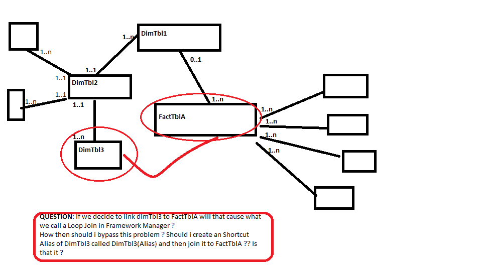

Anyone caould help me with a possible loop join issue ?
Thanks in advance to anyone willing to at leats advice something,
Join problem in FM

Join problem in FM
- IsThisaLoop.png (19.96 KiB) Viewed 156350 times

Re: Join problem in FM
Yes, alias shortcut is a way to address the join traps you see in the FM model. In the (g)olden days of Impromptu, we had the ability to define join weights and that was one way you could force the engine to generate the SQL path you'd want. It went way when Cognos ReportNet came on along with FM. We had put in a ENH request to bring that feature back into FM. It has been several years I last worked on FM. A lot might have changed, I am not sure if the join weights is introduced or not.tm1fmuser wrote:Hi,
You can find dozens of links in Cognoise or IT Toolbox regarding this problem.
I learning always to avoid modelling relations from Dim to Dim or Fact to Fact, but only let Dims touch Facts and vice versa. You could try to make first a join on all these Dim-tables to get a resultset ready to connect to the Facttable. Wrap this into an entity and join it to the Fact: Dim-Entity 1 .. N Fact. Some more similar stuff could be learned here: http://www.ibm.com/developerworks/data/ ... ge605.html
Note that FM is not a DBMS-Engine, but a tool to model entities under the special FM rules. Cognos generates from this queries in Cognos SQL which afterwards translates to the genuine SQL used by the DBMS. Check out here also: https://books.google.de/books?id=vQwYHs ... r.&f=false
