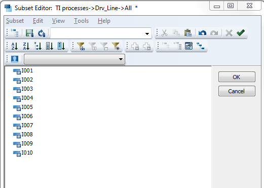

Here's an example with 2 dimensions. Say you have a Line dimension to capture input by the user. It has 100 elements, of which only a limlited number should show up for the user.
Below are the first 10 elements.

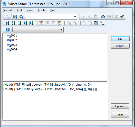

Then you have an Item dimension, containing elements:
You would like to filter the Lines to show the first 4 input lines, because you have 4 items in the dimension:
That might be one example.
