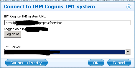

I have created a new TM1 server instance and that is not available on the list of available 'TM1 servers' dropdown as attached in the drop down.
We are on 10.2.2 FP4.
Older TM1 server instances that we created are available in the drop down. Is there something that has to be done before it's available?
Thanks in advance for the ideas.
Paul.

I think first you have to login to the pmpsvc portal and add the new server to the available servers. Sorry, I cannot login now but there should be an admin screen where you can add servers.

Thank you. That did the trick.
