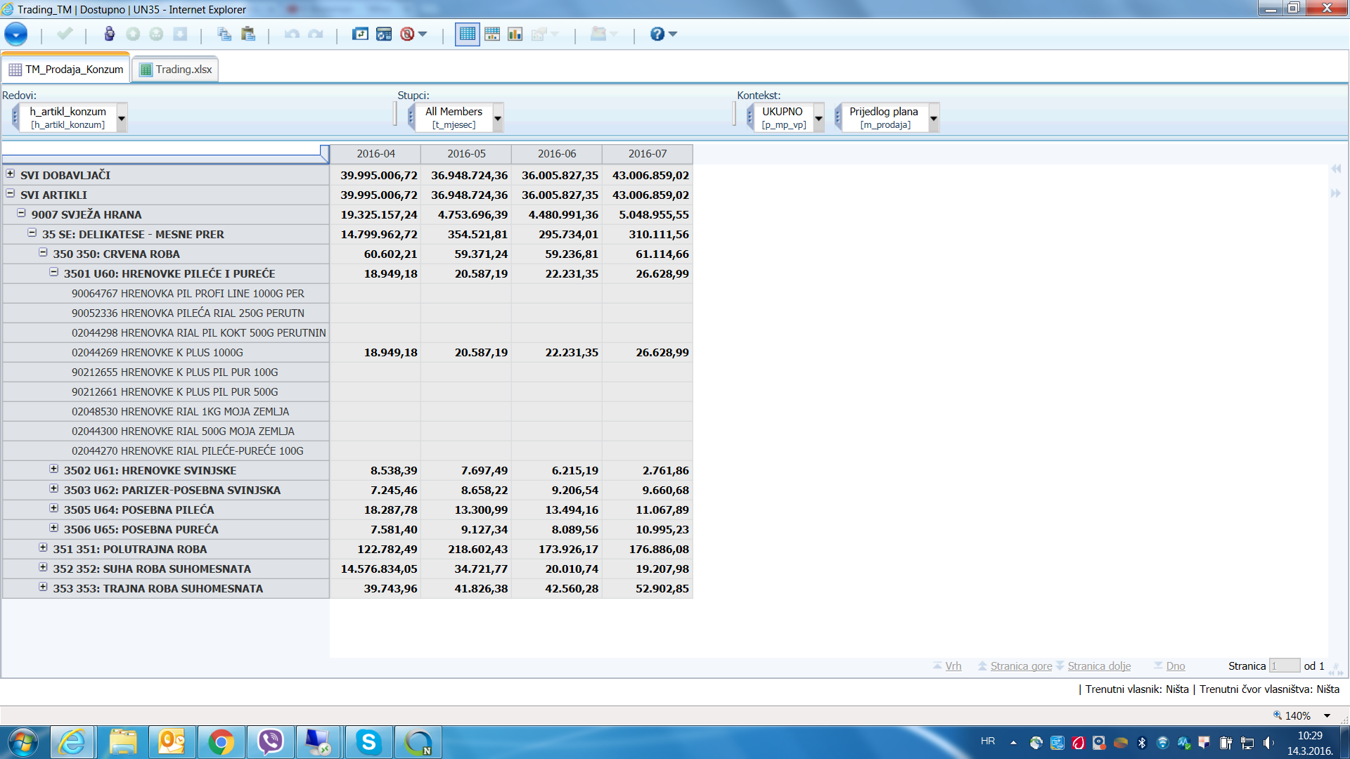

My situation is following.
I have a cube with 4 dimensions:
- Time diimension t_mjesec (holds four next months and previous month)
- Measures dimension m_prodaja (consists of 4 measures, on image is show Prijedlog Plana - Proposed Plan)

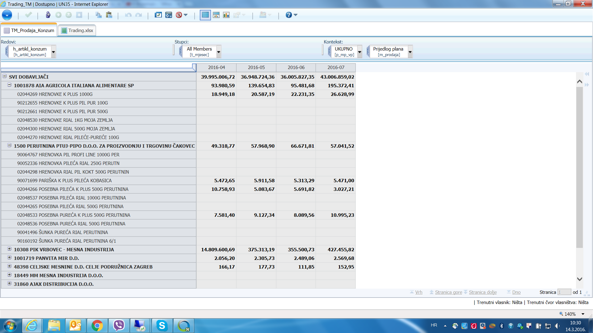

- Hierarchy dimension h_artikl (created using data from the table from database) - list of products that has 5-level hierarchy. Also, we created alternative hierarchy based on suppliers for each product. This hierarchy has main consolidation level called SVI DOBAVLJACI - All Suppliers, and has two levels above level 0. Main hierarchy's highest consolidation level is SVI ARTIKLI - All products.
- Generic dimension p_mp_vp (consist of two elements and their consolidation)
Main hierarchy for products is:
Level 5: All Products (SVI ARTIKLI)
Level 4: Sectors
Level 3: Categories
Level 2: Groups
Level 1: Subgroups
Level 0: Products
Security is based on 3rd level of main hieararchy for products - categories. Each user has one or more categories he is in charge of and he can se only his node of data.
Problem is that even though user sees only some categories, on sector level is shown sum of all the categories in that sector, and it should show only sum for categories that user can see.
I have the same problem with alternative hierarchy because it shows sum for all of the products for one supplier, and user cant see them all (only few).
Is there any way of achieving this without adding another dimension in cube?
We have set Element Security and Cell Security set. Users see cube through TM1 Web Application whose type is approval.

maretm1 wrote:I was hoping that this was resolved with new fix packs or something
Hope this issue will be solved with new releases. :)
Don't think so... This is so fundamental in the algorithms in TM1 that I doubt this will be possible any time soon.
Nevertheless it would be useful in some circumstances, though we must be cautious when values at C-level can change depending on who logs in.
Re: Summation on consolidation levels depending on security
Posted: Mon Mar 14, 2016 11:12 am
by maretm1
tm1_bloke wrote:I am afraid that this will not be resolved in coming fixes. This is the way that TM1 security paradigm is and has been "always". And like I said, we can argue whether this implementation is correct or not. In my opinion, the existing way is the correct one - if you enable user to see consolidated value, it is obvious to me that all users will see the same value, not the value that is derived from their individual access rights to the children of consolidation.
But that is the number that they mustnt see, they can only see their values.
And it doesnt create big problem if you have one hierarchy, and you can hide consolidated levels that they shouldn't see (in this example I can hide Sectors and All products, and this should be fine), but when you have alternative hierarchy in the same dimension, then this is a problem.
