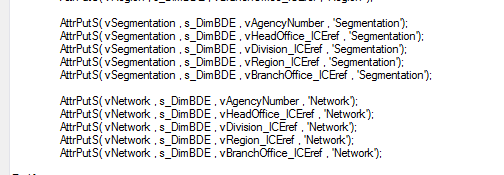

Hi - we are not doing it manually but via TI.
It adds it for 'Agency Number' which is N-level but not for the others - 'Head Office', 'Division', etc., which are consolidated elements.
Above is the code in the 'Data' section of the TI.

Is your attribute an alias or text? If an alias, does the TI finish successfully? If not, have you check the logs? Are you trying to assign duplicate aliases (same vSegmentation across multiple elements)?
BR, George.

Are you sure that the variables you are using contain the right elements you are trying to update?
May be helpful to asciioutput each of the variables list in the AttrPutS statements after the vAgencyNumber and see where TI is trying to send the attribute values.
BR, George.

wigglyrat wrote:Yes. I am able to type in attributes manually for these, however the TI does work for the N Level in the code above - the first one 'vAgencyNumber' but not the others.
You do realize that vAgencyNumber is just a variable name, not a value. It's a value when it is assigned a value in your code or assigned a value from your input source. Where is the value stored in vHeadOffice_ICEref coming from? Are you sure it's not empty or pointing to the wrong element. You need to put an ASCIIOutput statement in your code to write the values from all your variables into a file so you can see what's in there at run time. It's really the only way to debug TI processes.
Re: Can you add attributes to C level elements?
If I had to bet it's that either:
(a) Your code is not doing what you think it is; eg there may be something in your code that is causing it to skip the consolidations, which is why the RFA guidelines request the complete code; or, equally likely
(b) Your data source does not include the consolidation elements, meaning that the write action never occurs in the first place.

Trying ASCII output proved it was adding the correct variable to the right element, thank you for this suggestion.
This code above however, was initially in the 'Data' tab. Moving it to 'metadata' has solved the issue and now the attributes have been added.
Can anyone please explain why moving it here would make a difference?

wigglyrat wrote:This code above however, was initially in the 'Data' tab. Moving it to 'metadata' has solved the issue and now the attributes have been added.
Do you mean just the code you're showing us, or also some other code that goes with it?
AttrPutS is a data manipulation function, so can be used on any tab of the TI process. It is typically used on the Data tab because that ensures that the changes to the dimension are committed after the Metadata tab and all the required elements are in the dimension when you're trying to populate their attributes.

The chances are that there is operation ( prior to at attrPutS ) in your data tab that has skipped over the attrPutS.
While leaving in metadata tab may work for now, it is not recommended. Depending what you are doing in your prolog and metadata tabs, this can cause potentially issues further down the track.
